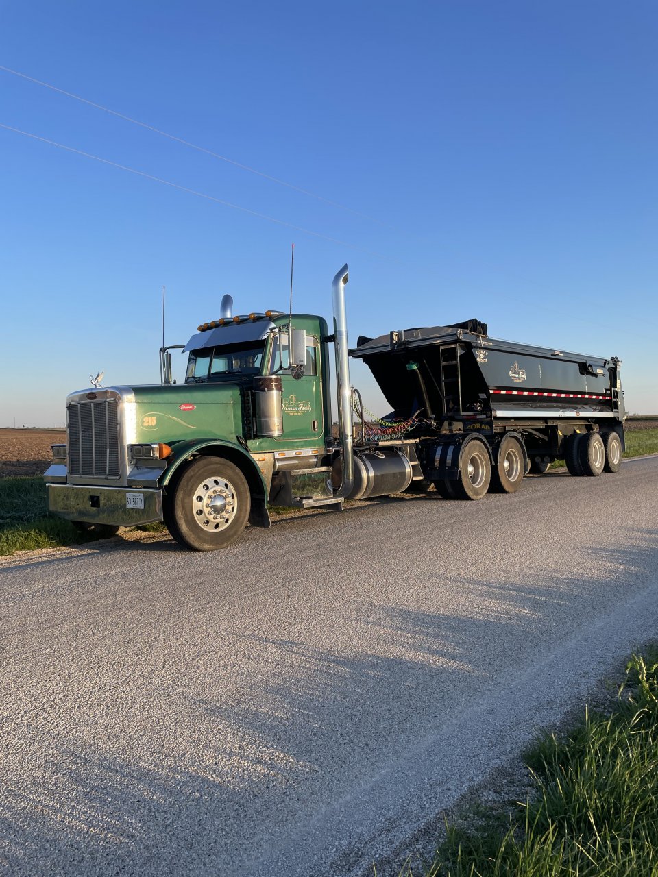

    05 Pete c13
    Truck is brake to Jake via computer which was working fine cruise worked high idle.
    now it jakes no matter what all cruise functions are gone
    brake lights are not stuck on jolly valve and brake u can hear switch activate.
    clutch and throttle still disengages jake
    all switches appear to be functioning but the truck thinks the brakes are being applied why Jake is on without brake and no cruise
    any thoughts?
