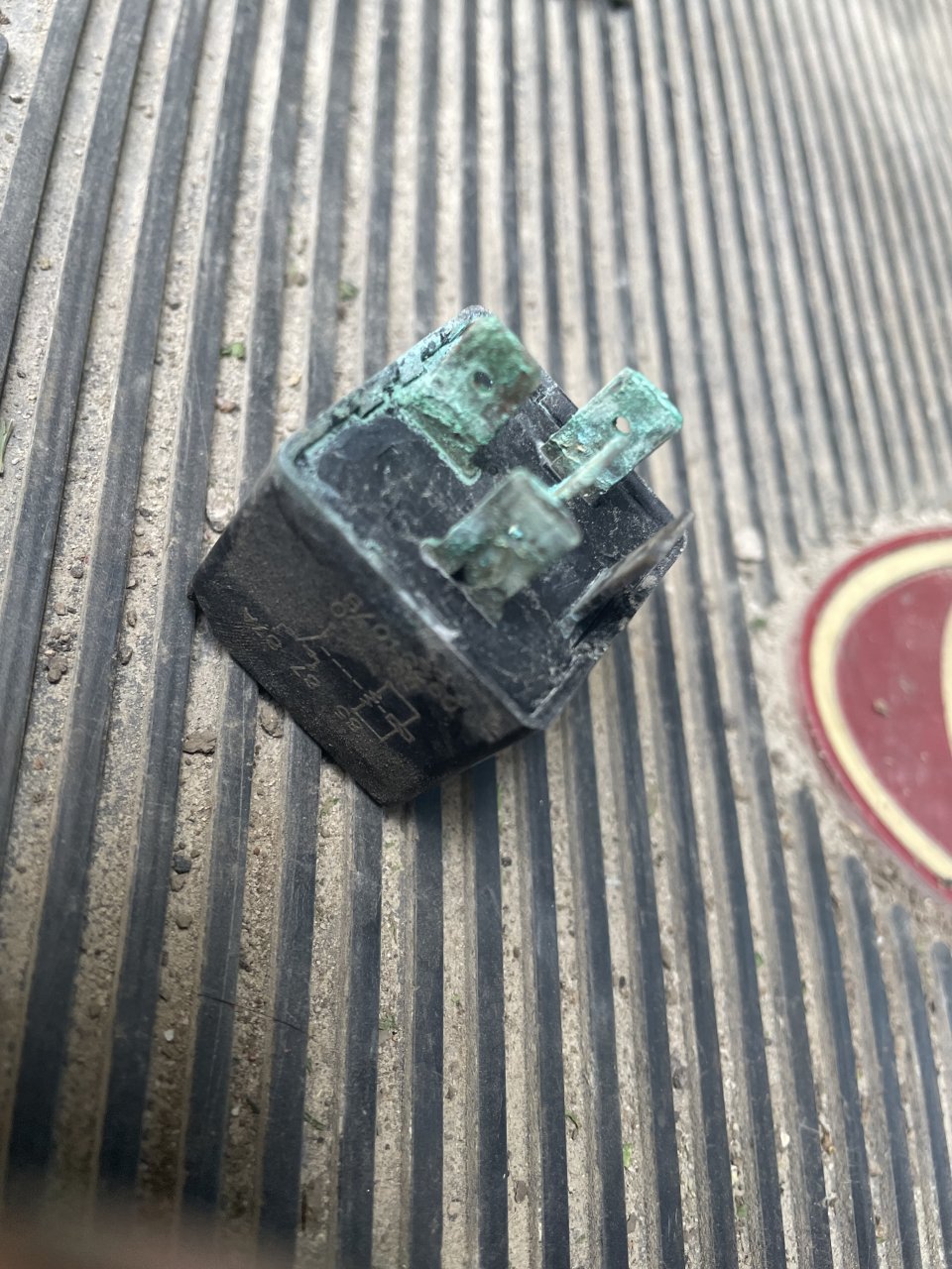

    With this info now, Im now leaning towards your brake pedal switch being the issue, dont remember on petes where that is, more familiar with older kw setups, but try to either lift up on the brake pedal or see if the brake switch is misaligned

    so your cruise control isn't working at all correct? Your Jake's work fine but basically come on all the time?
    If this is the case I'd look at your brake switch. I think, could be completely wrong, it's behind the kick panel behind the pedals. There's a couple air switches back there. low air and such.

    I did what most do think simple check fuses first. Checked a bunch and hosed it with electrical cleaner. It started to work correctly. Later the next day same
    Issue.
    went in pulled every relay every fuse replaced a bunch a fuses with ones in better shape cleaned every connector sprayed cleaner and used air and it fixed it once again

    I had a issue like this 2× b7t a little different 1st was no cruise but Jake's worked 2nd was cruise WOULDN'T DISENGAGE with the pedal..
    Both times it was a corroded pin (different pin each time) on the plug going into the ecm... also did it a 3rd time when the accelerator pedal stopped working
