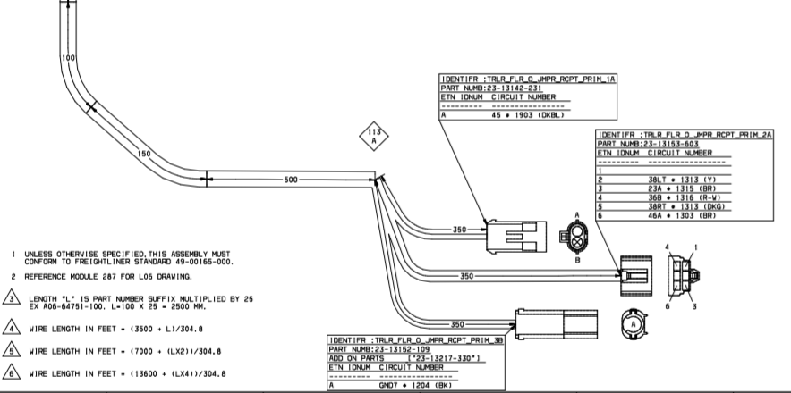

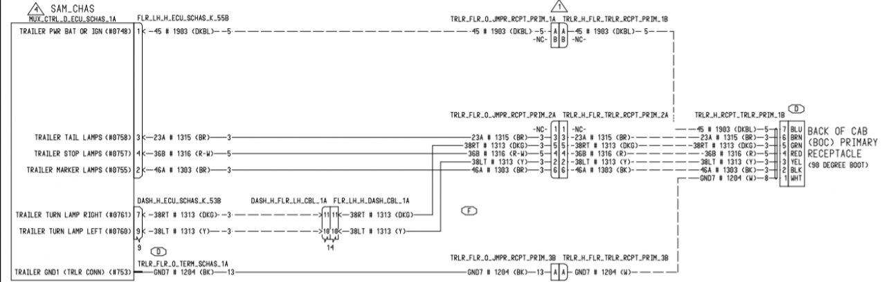

    @SWM_TECH is correct about your configuration if you want power to be supplied all the time or only with IGN based upon a 5 or 4 pin relay, respectively. That is why on the schematic you will see "Trailer PWR BAT OR IGN." On this unit, you have a P3 Cascadia. I think some refers might need the 5 pin relay for continuous power or some configs like that.
    At any rate, your SAMCHAS is responsible for your BOC 7-way.

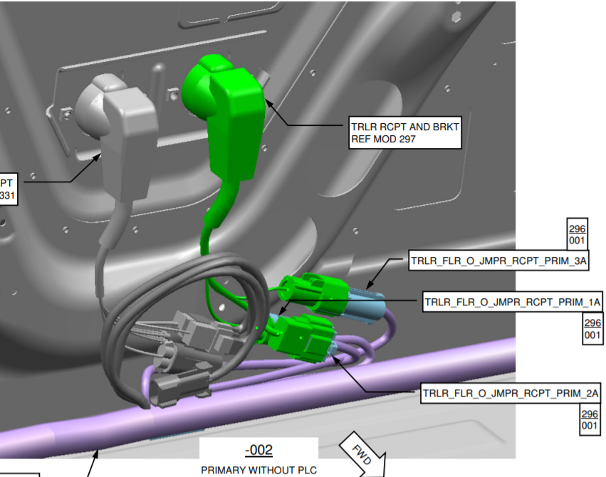

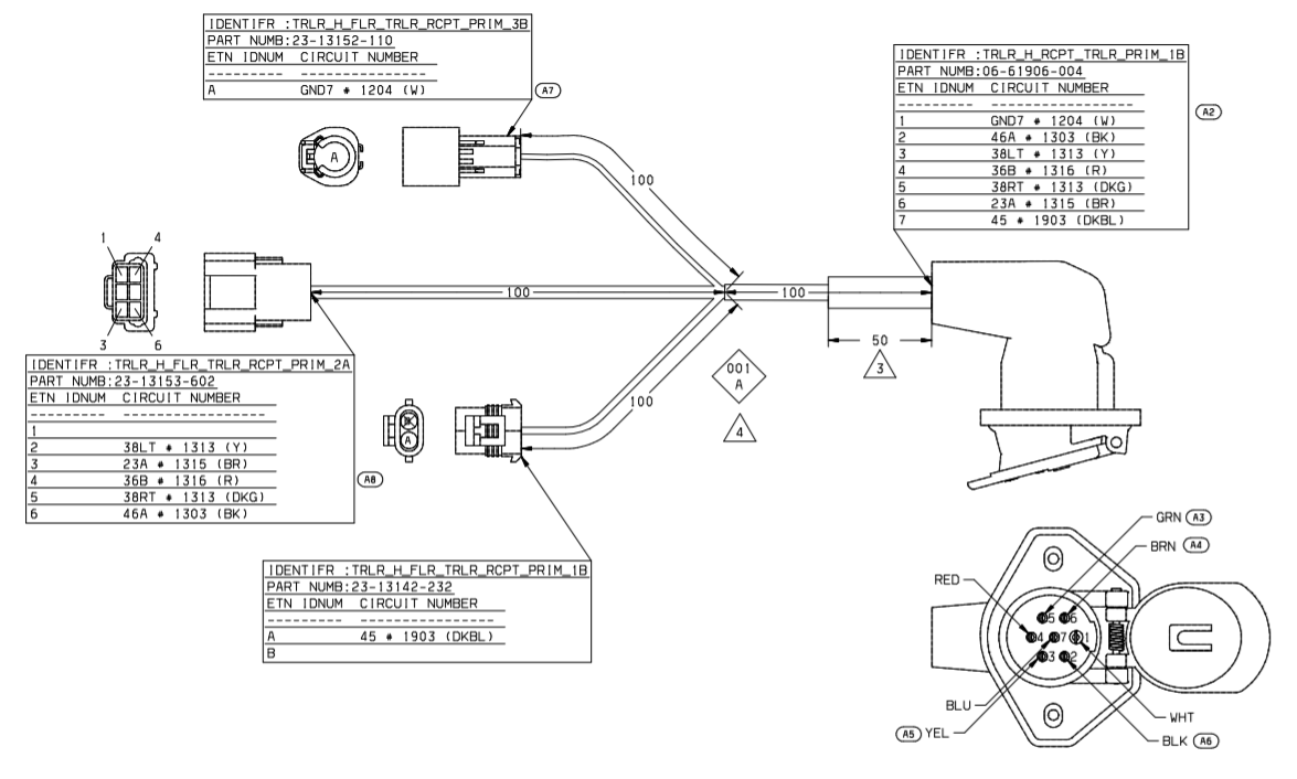

    I would check the wiring from the SAMCHAS to your 7-way. You could have a compromised circuit 45 or something in the middle. Here in green is your 7-way on the INSIDE. Labeled are the connectors to check.

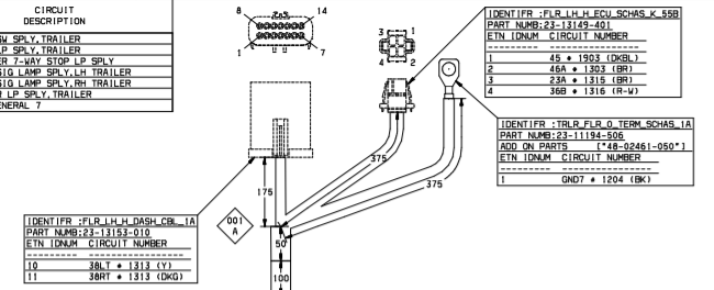

    Here is that intermediate harness for the 7-way. Maybe something is going on in here:
    Then on the other side to the SAMCHAS it could be this wiring:

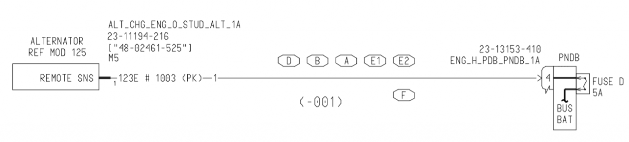

    P.S. 14.63v is too high. Your truck has a 36SI alternator. You should be utilizing the voltage sense wire for the batteries to be at 14.2volts. If this circuit is compromised in any form, you'll get high voltage spikes. If it is open circuit, it will go to a "nominal" voltage regulation level and could possibly end up under charging the batteries.
