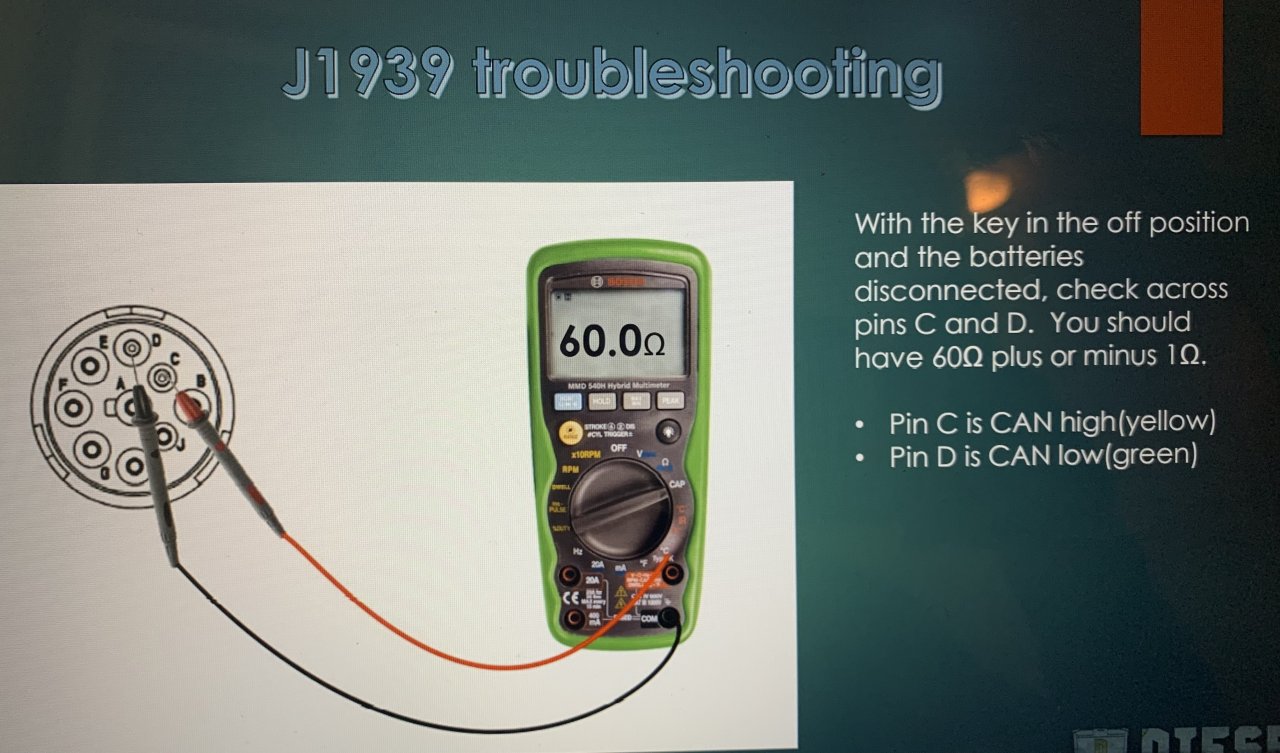

No start. 2014 Cascadia. Ultrashift. J1939 No trans code on dash. Fuse? Please help.

    no problem,yea man alot of times th happens and it can only be a data bus issue...there a ##### to diagnose but its worth it before gettin your rig towed

    Another dumb question but Im not at the truck right now is this the diagnostic port in the cab?

    yes your 9 pin connector under stearing wheel

    Thanks so much I will check it out and report back!
