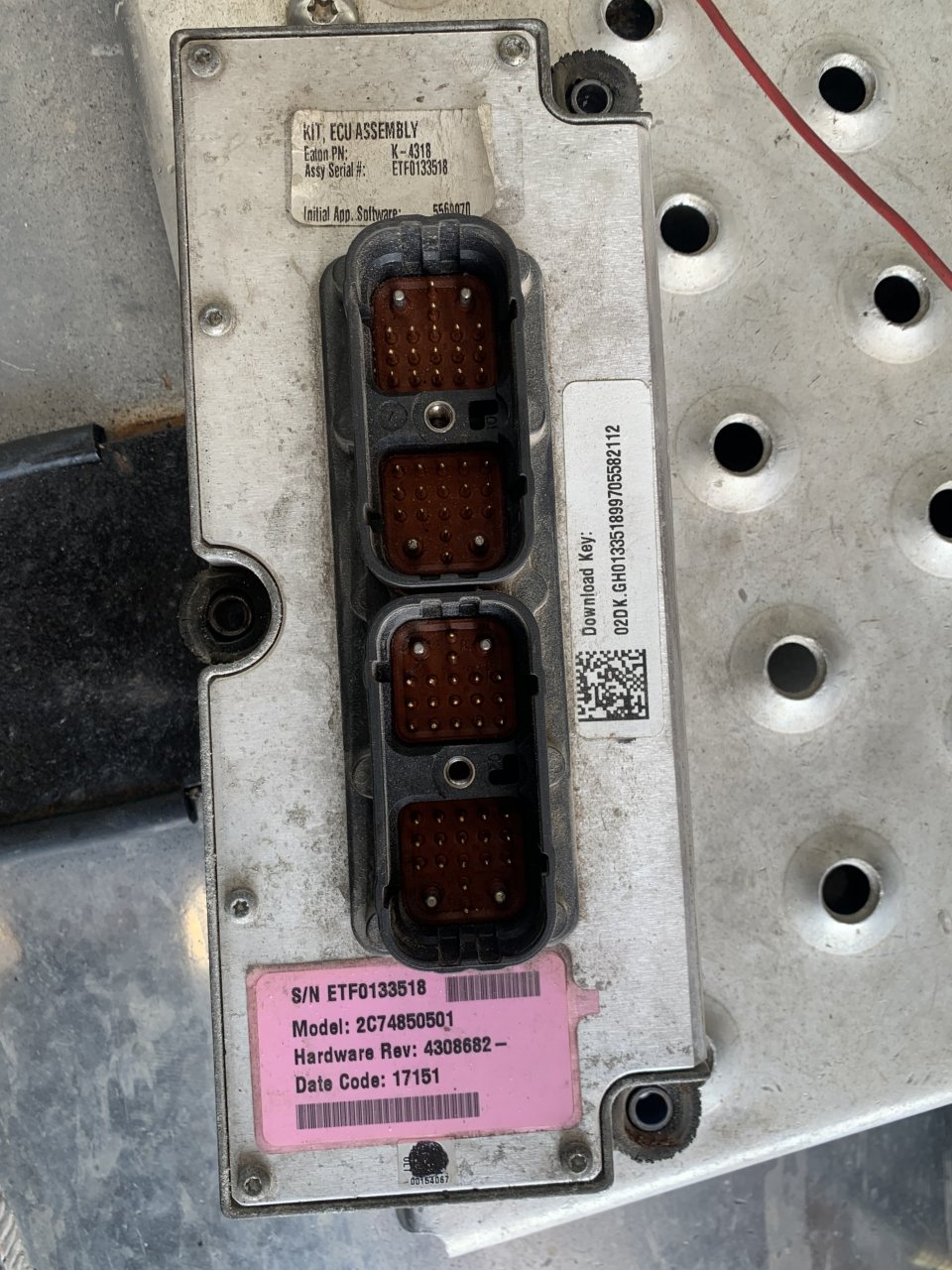

    The TCU is located on the left side of the transmission:
    The 30 amp fuse is the supply to the TCU that needs to be checked:
    Disconnect the connector to the TCU and verify any water intrusion and also determine if that circuit is a short to ground (with batteries disconnected). Pin 38 to on the TCU is the batt supply. DO NOT poke and prod the pin on the TCU connector--use something that won't compromise the pin. Be careful!
    One thing that I need to reiterate, is that when verifying the J1939, you need to make sure the batteries are DISCONNECTED in order to statically test the terminating resistors. With both 120 ohm terminating resistors installed, you should see a value of roughly 60 ohms--with batteries DISCONNECTED.

    Went to the shop today and transmission computer apparently is bad. Can’t believe it but I guess it’s $2500 for a new one. Is it often these just go bad? Ugh. Any place to buy reman or off a salvage truck? Thanks guys.
