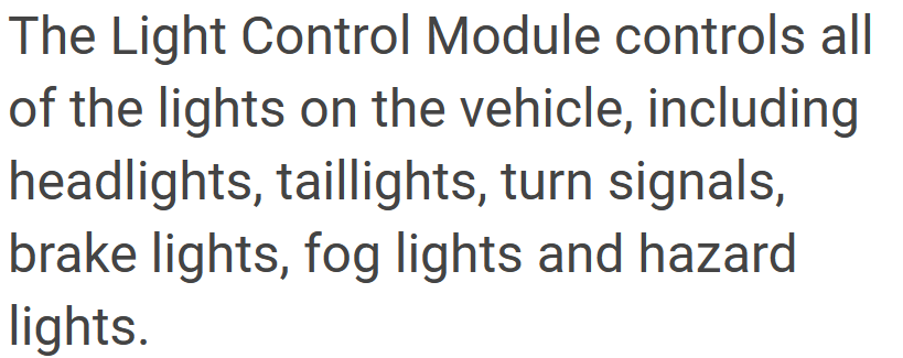

    Check all the way from the node and we’re getting 12 v and replace all the harnesses and head lamp assembly and still nothing the node is like a relay panel under the sleeper mounted to the cross member and when they started putting all the def c
