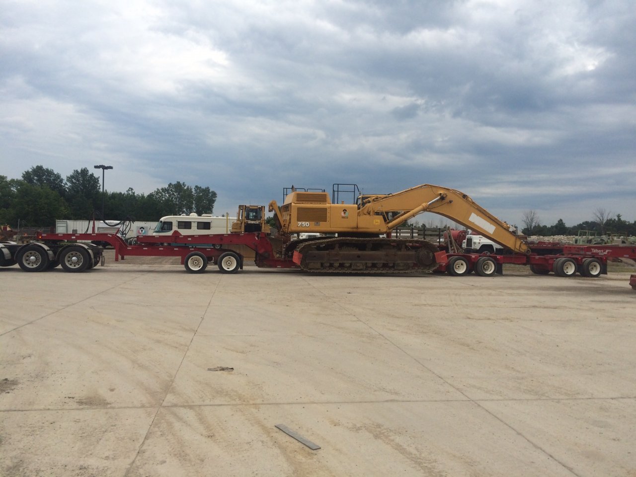

    No, you really need the shim at the deck to level the trailer bogie. You can raise the neck some to do it but that’s not ideal. With a distributed load it’s possible but with a concentrated load you need yo shim.
    cke and Oxbow Thank this.
  3. Kawinige01
    Kawinige01 Heavy Load Member
    864
    1,150
    May 30, 2016
    South Fla
    Ok got it. Something super heavy would require more shims to even the axle weight out
  4. johndeere4020
    8,522
    119,294
    Jan 1, 2010
    Yeah kinda. You take something big that’s sitting on tracks it’s distributing the weight over the length of the tracks or an RT that’s blocked at the front and rear vs something setting in the middle like a crane or excavator without the tracks where the weight is concentrated you have to shim differently even though they may weigh the same.
    shogun, stwik, Nothereoften and 4 others Thank this.
  5. johndeere4020
    8,522
    119,294
    Jan 1, 2010
    On an east coast trailer you have to shim so that when you’re loaded your bogies are level. For this excavator before I loaded but after I shimmed with the air deflated the front trailer axle was off the ground. That’s 125,000 setting in 10 feet. 5E98CC4B-E82C-405C-A372-C88BD8B0A8DD.jpeg
    Here are the weights on the DOT’s portables. 90B9568D-F2A5-4DA0-B522-58C1327234C8.jpeg
    I was pretty close with my shims. I could have pulled some spacers out of the gooseneck and that would have easily brought 6 and 7 more equal but it would transfer weight from 8/9 to 6/7 and lower the front of the trailer. I could also have pulled a 1/4” out of the deck shims which is difficult with a load on. If I pulled a shim on the booster it would have helped equalize 6/7 with 8/9 but I was fine on my permits. Had that been on tracks where the weight was distributed the shims would have been wrong. It’s as much art as science.

    The guys that work with modular trailers have to carry lots of extra shims, one or the main reasons for different shimming on a same weight load is that a concentrated load will change the arch in the deck and therefore the shimpack will change to level the axle set while maintaining deck height.

    I see that a lot of the older west coast 2+2+2 set ups had air jeep and booster, but walking beam on the trailer. To a degree that would alleviate having to be so precise on shimming the deck wouldn't it?
    shogun, cke and johndeere4020 Thank this.
  9. johndeere4020
    8,522
    119,294
    Jan 1, 2010
    Shimming the deck isn’t critical at all on a west coast for weight distribution because no matter what you put on the deck the weight ends up on the trunion between the bogies. The only reason I shimmed my west cost was to get ground clearance.
