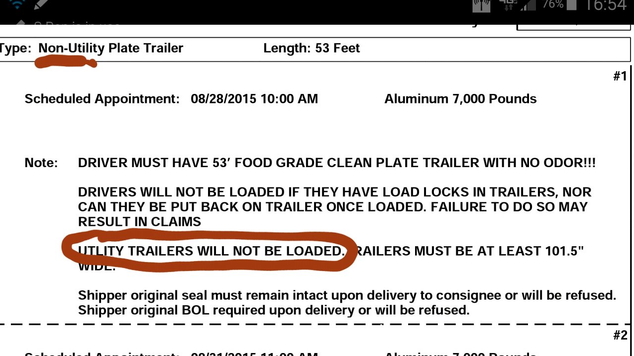

    First time I've seen "no utility trailers" on a rate confirmation: Screenshot_2015-08-28-16-54-13-1.jpg

    They specify plate trailers. Utility does not make any plate trailers.

    True, though they market their 4000dx composite trailer as an upgrade over a plate:
