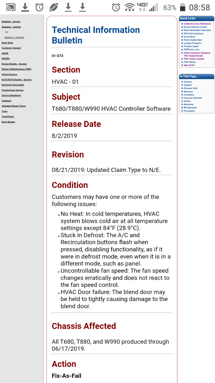

    You likely have a intermittently shorted temp door actuator or possibly a broken door as they are plastic and have been known to break. The blower random shutoff is common when faults come active in the system.

    A lot of HVAC been addressed with software updates. Screenshot_20191013-085821.png
