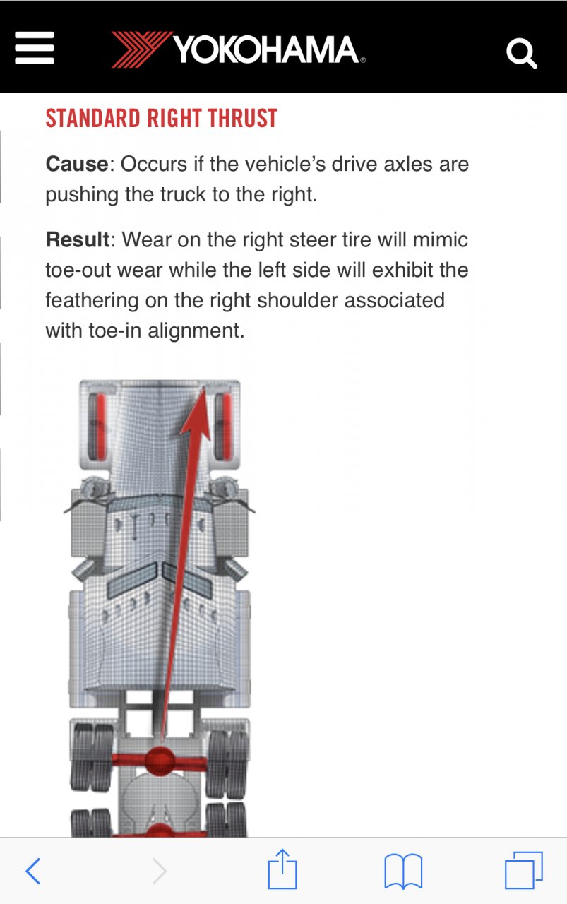

    E4801190-DCDA-4383-8F7F-37EA538B1E5D.jpeg I know what the alignment company said but here’s a good illustration of your problem.
    Notice where the wear points are on the front tires.

    That looks like alignment wear to me. Does out of balance cause steer tires to wear on opposite sides of each other? I thank not just accelerates wear from another problem.
    Could not read your alignment print out but many folks only know how to do what the machine says.
    A: A vehicle will pull to the side with the most positive camber.
    B: A vehicle will pull to the side with least positive caster.
    C: The rear axles determine which direction the vehicle will travel like a rudder. Also referred to as the thrust angle.
    A,B and C can be within specifications and cause pull when two or more of them work together in the same direction. Then the steering wheels must correct the situation for the vehicle to go straight down the road. Often resulting in an off center steering wheel.
    While beating my head against the wall Snowey pointed out that even semi trucks can be victim to radial tire pull. Rotated the tires and it pulled the other way. Thanks Snowey.
    Hope your truck no longer pulls. If it does you way wish to look into it further before you loose another set of tires.
