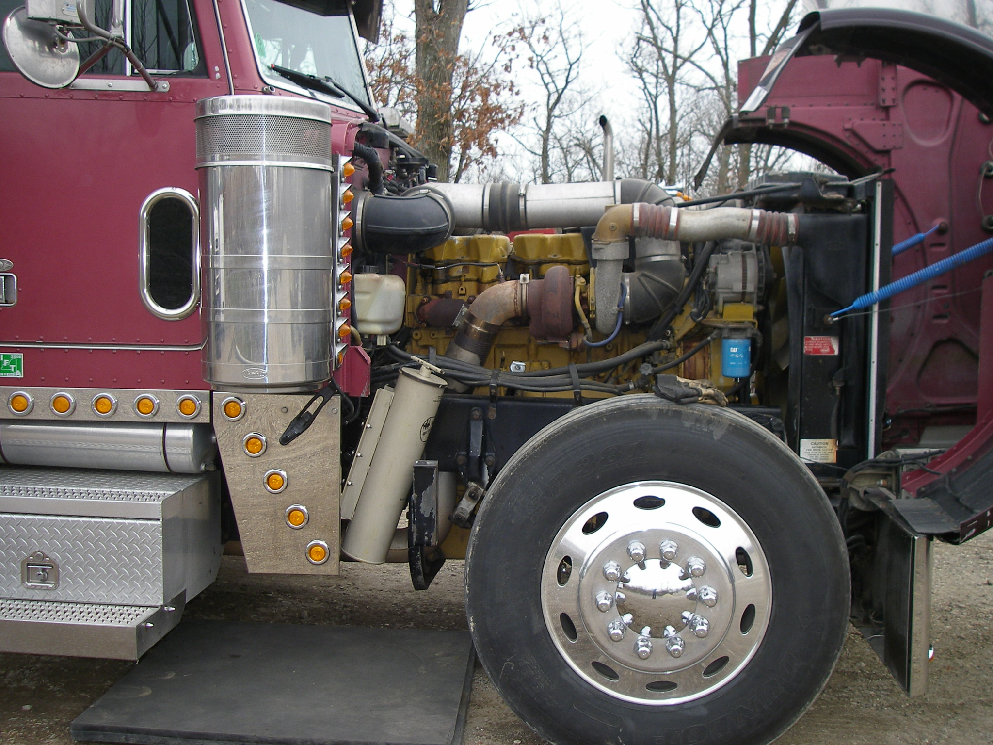

    I use Gulf Coast Filters GCF1. I sample every 10k, change filters every 12k. little over 100k on oil and samples coming back near VOA every time. Gulf coast does the interpretation of each analysis.
    Gives me a lot of confidence in the internal health of my 3406E.
    Bought the GCF1 housing used. Sourced the braided lines and fittings from a speed shop. Fabbed mounting bracket myself and installed an inline ball valve from McMaster for sampling. All in just under $300. Money well spent.

    What does it use for filters?
  10. Luwi67
    Luwi67 Heavy Load Member
    714
    449
    Oct 24, 2012
    Long island
    It used to use 2 rolls of paper towels. Now they require using their filters which are a roll of paper towels with a fabric sock around them.
    Reason for that is GCF claims they were finding cellulose in the samples so they came up with this solution.
    You can use plain old paper towel rolls but, if they find cellulose in the samples they will no longer interpret the the samples for you. In other word you wont be able to participate in their oil analysis program.
