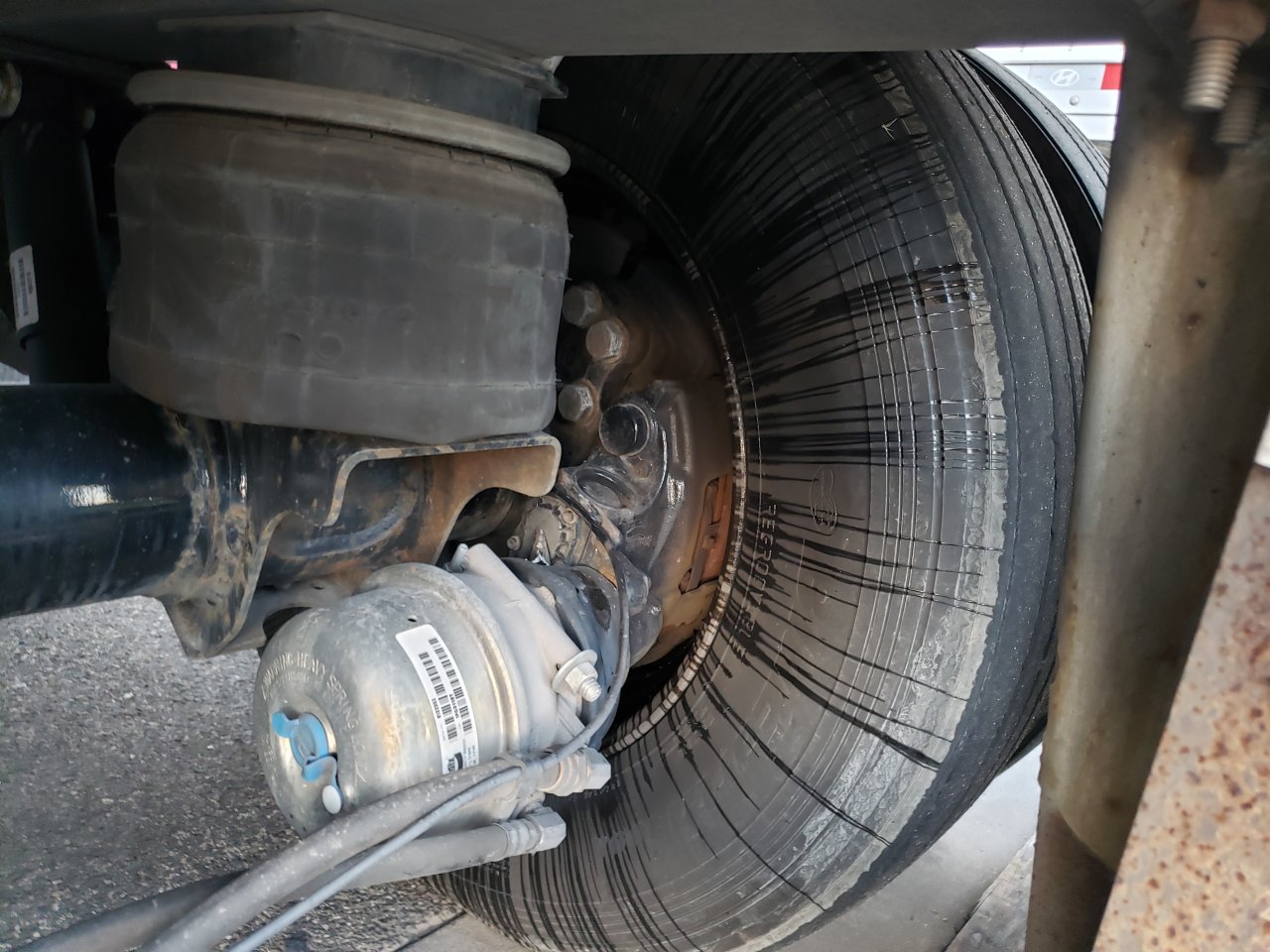

    Maverick trailer, grease hubs and tire inflation system.
