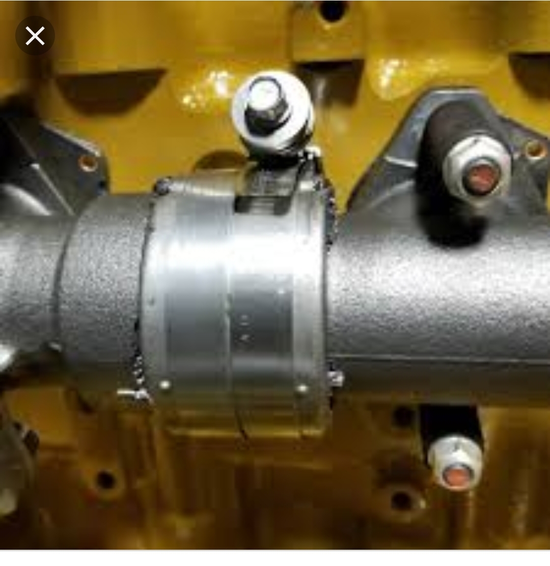

    They make this ^^^^^^^ for this exact reason. Go to cat and purchase them and install.
    Theres nothing wrong with your engine and compleatly normal

    What's that called?
  5. swaan
    swaan Road Train Member
    2,942
    4,374
    Jul 12, 2009
    BC canada
    I'm not exactly sure what the name for them is. They are anti slobber exhaust manifold slip joint seals.
    There made to absorb the extra fuel slobber then burn off when the manifold gets good and hot later.
    Dino soar and Wheeljack Thank this.

    Cat just calls it packing.

    I have always called them "diapers". I'm sure its slang though.

    Is this it?

    I thought they were called slip joint packs.

    I believe that is an old part that may be obsolete. The newest updated part is a white wrap 1" wide that looks like insulation. You will need the clamshells and clamp to match the new gasket. They are pricey and a PITA to install. I usually put em on with the manifold on the bench.

    A Full tilt manifold is the best solution. Cat Chinese ones aren't as good as the old ones that used to be cast in USA.
