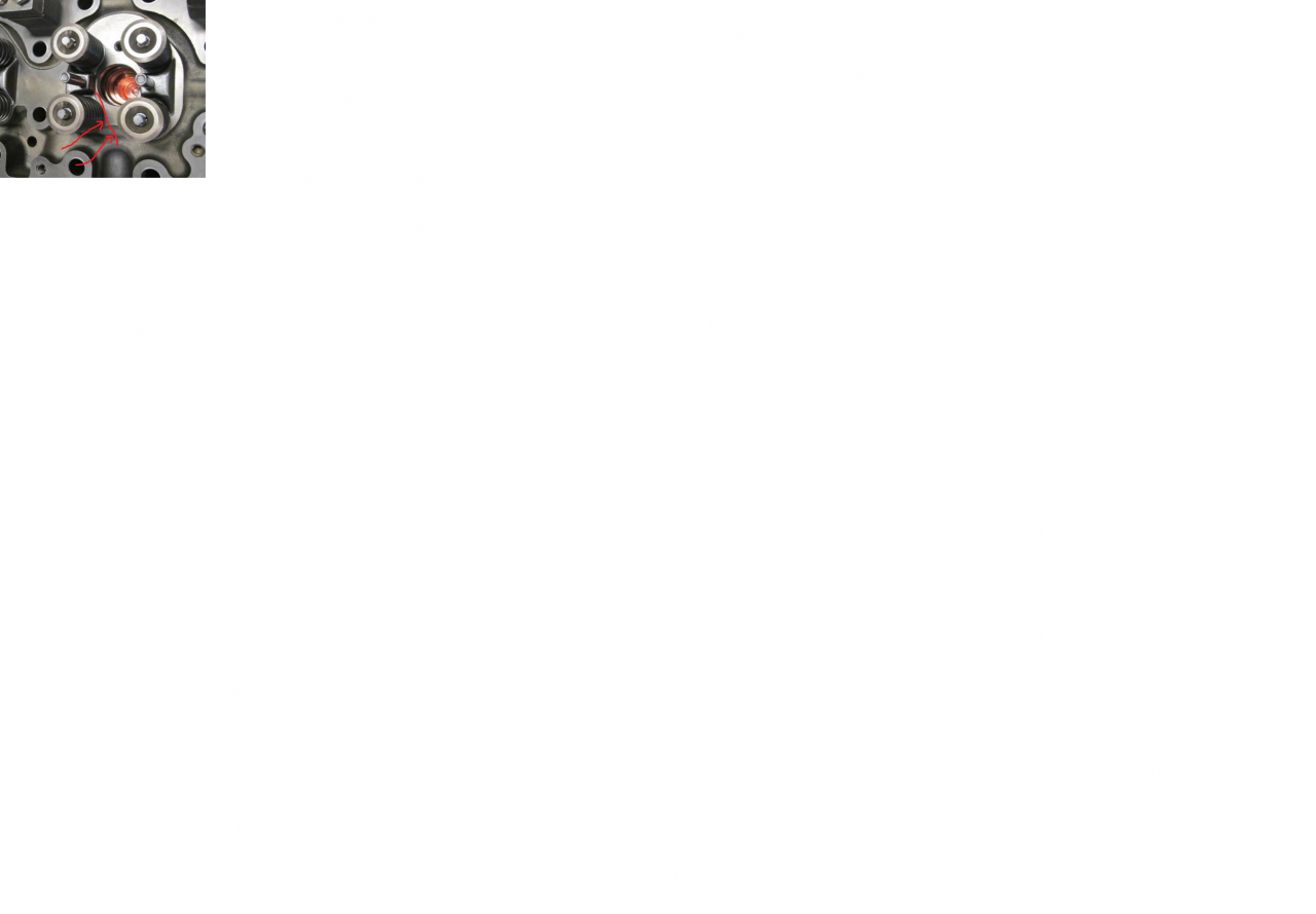

    I was being charged $1000 for injector Seals & cups. Till we found its a cracked head.

    my head is cracked between injector & valve. You need to air pressurize the system to locate the bubbles coming out.
    I initially thought it was the rings & cups, only to find out it was a cracked head along a fuel channel (fuel is supplied/returned thru the head)
