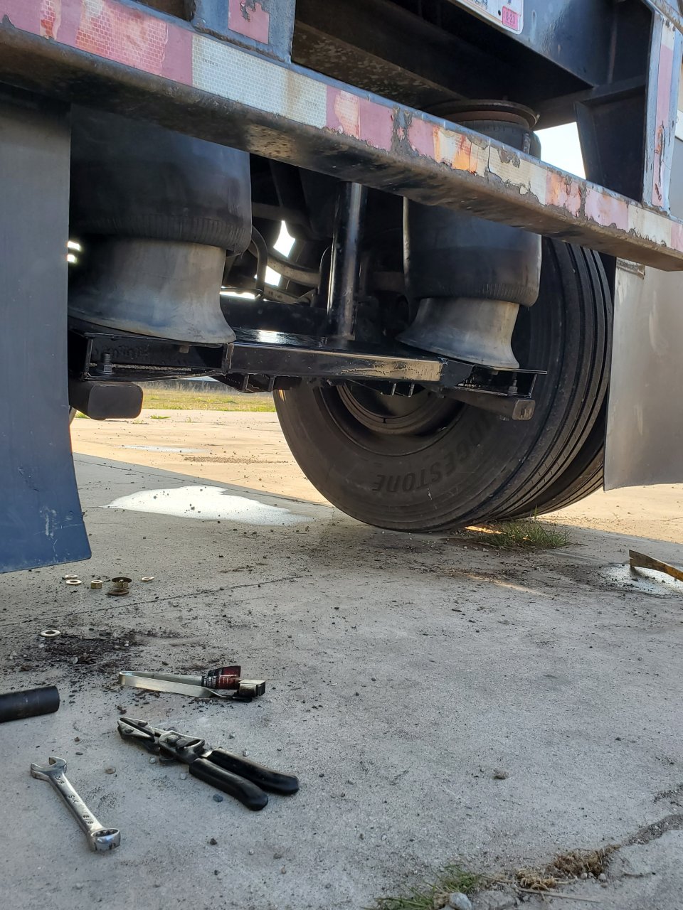

    Call me out like that. Thought we was buds. Or your implying I'm hard on stuff. I don't always prefer to change air bag crossmenbers outside. But when I do, It's in a Sunoco parking lot loaded. Nightime job in the daytime.

    What the H E L L did you do? I was complementing you....looks like I spoke too soon?
    But you are qualified to work on it...in a Sunoco station. :)
