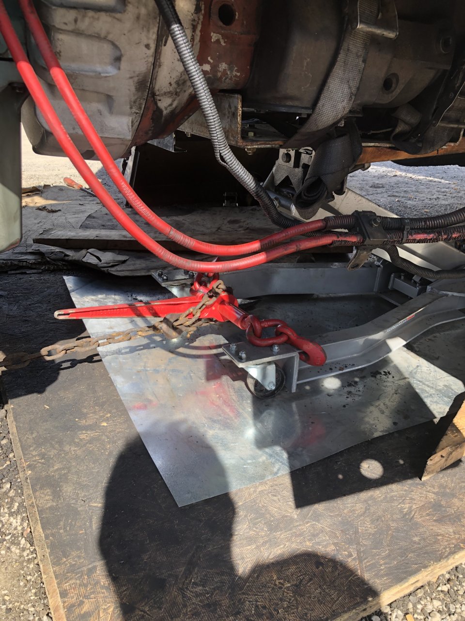

    That’s a fair price,$5000. I’ve heard as high as $7500. I did mine last year, myself. Clutch, rear main, re sealed the rear cover. New mounts. Maybe $1400 in parts. And it only took me 7 weeks to do it. Lol. You get the point!! Never again. I’ve never been so sore and greasy, day after day. But I did it my way. Learned something, mainly to leave the heavy stuff to the Pros. It was a tough job.

    She had to help. “ I didn’t sign up for this!” Lol. Oh yes you did!! She barred the engine over, while I torqued the clutch. Complaining the whole time. I had to make her bar it around one extra time, just to get even. Lol. She did a great job also, pulling the trans with the chain and p/u, had her on the phone, while I guided it. Luckily it lined right up. She’s a Trooper, alright. Once towed me with a chain across the Greater New Orleans bridge, in rush hour traffic. Using hand signals. Lol.
