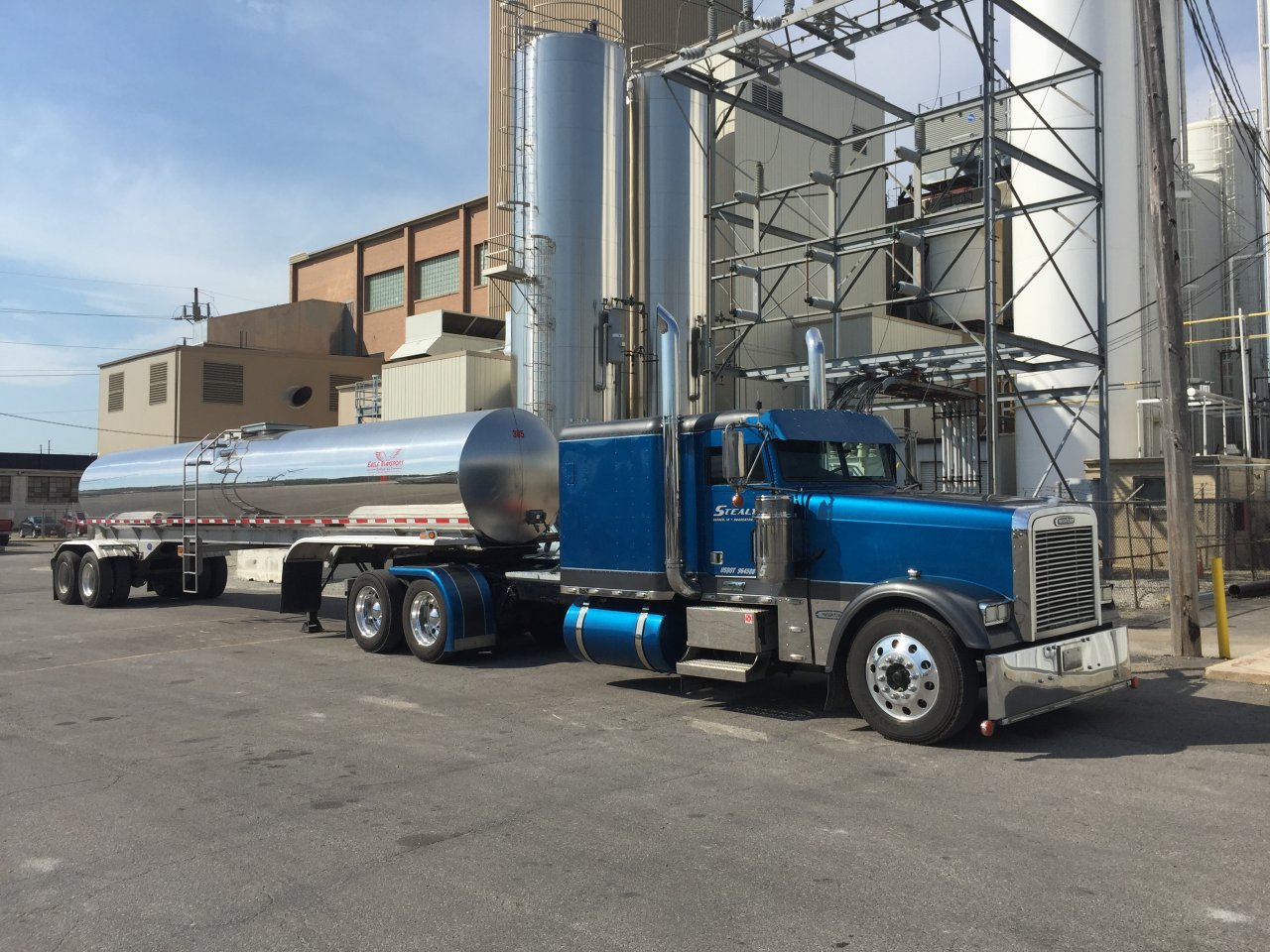

    Umm... I can try the list is long. I acquired at the beginning of august 2017 the truck was last used 11/09 so had major dry rot issues, but no rust.
    exterior went something like this
    New tires
    New Brakes, drums, chambers, and air lines all around
    Two new front rims
    New front hubs, bearings
    New Kingpins, tie rod ends.
    Converted old wore out ag200 suspension to ag400
    Eight new suspension airbags
    New shocks all around.
    New cab airbags and shocks
    New Tank Strap Rubber
    Pulled fifth wheel rebuilt it, changed slider cylinder
    Exhaust from elbows up new
    New grill
    New bumper
    New air cleaner cans
    Removed QUALCOMM and roof bracket
    Painted Fenders and Frame black
    Lights, wiper blades
    New mud flap hangers and flaps
    Polished tanks and rims
    Headache rack, catwalk, saddle boxes, half fenders
    Replaced a bunch of rusty bolts with stainless bolts in the mirror brackets
    Under hood
    New radiator
    New AC condenser Compressor, expansion valve, dryer
    Blower motor
    I replaced some missing parts on the engine first and ran it for awhile then 40,000 miles after getting it back on the road I was getting metal shavings in the oil and developed multiple oil leaks.
    Pulled engine and replaced with a rebuilt.
    New clutch
    Changed trans and rear end fluids
    New top transmission shifting tower
    Steering gear box
    Interior Had to get some used parts from salvage yards for this.
    Major scrub down
    All new air vents replace broken or missing
    New driver side seatbelt
    Had tears in seats reupholstered
    All New toggle switch indicator lights
    New radio and speakers(missing)
    Used speaker covers from salvage yard
    Used dash plaque labels from salvage yard
    New low air buzzer and changed dummy lights while apart
    New fan speed switch.
    Used upper center console cover plate from salvage yard(missing)
    New fuse box door
    New shifter knob
    Couple of New toggle switches
    Properly ran new cb coax cable through headliner down through dash
    I know I'm missing stuff
    I'm $60,000 into this truck. But this truck is so tight, drives like a new truck and its eld exempt can't put a price on that.
