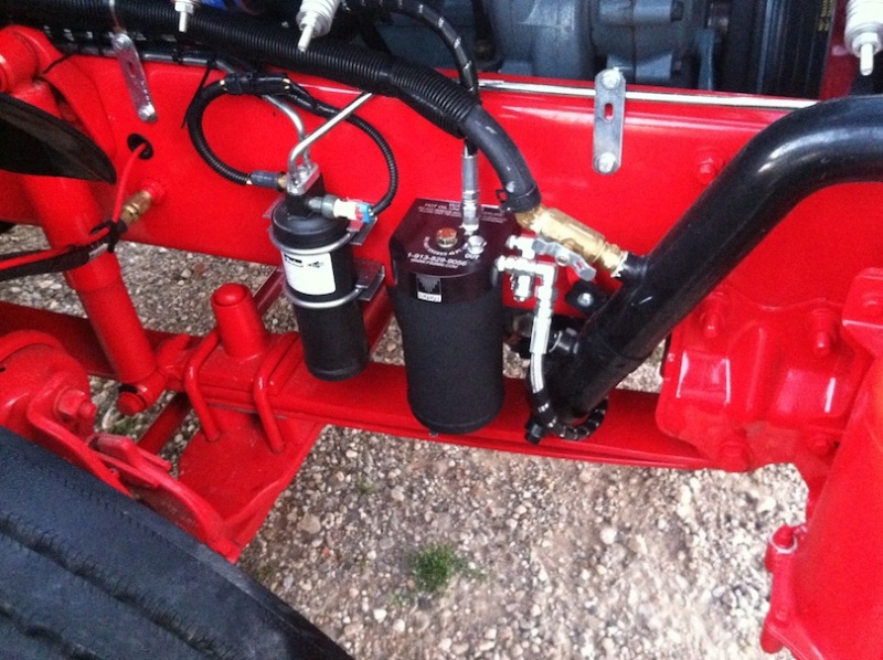

    I have used the FS2500 on my last two trucks and like it. Bypass filters are a tit for tat deal. All of them do a great job, just find one that fits with what you want, what you want to pay, and how easy/hard it is to install and service. Best I can recall, my FS2500 unit kit was a little over $500 for everything, but I am sure that has changed by now. It was a clean, simple install, is very easy to service, virtually requires no makeup oil when you change the filter, and does as good of a job as any other bypass filter.
    The FS2500 comes with all fittings, hoses, unit etc specifically set up for your truck and engine combination, and can be installed pretty quickly. Both times, I had the FS unit installed myself in less than an hour. They recommend changing filters every 10,000 miles, but that is because they want to sell filters. On an ISX, and now on my Series 60, I usually go 20,000 to 25,000 miles on bypass filter changes. You can tell the filter is still good by feeling the canister when the engine is running. If it is hot, then oil is flowing thru it and it is still not used up. And it is common knowledge that filtration gets better as a filter starts to accumulate stuff. As long as the oil flows thru the unit, the filter is not in danger of not being changed.
    I have never had a soot level above 0.2 ppm on any sample. Last sample was 0 with 20,000 on the filter.

    what isx engine did you have? Nice freshly painted frame.

    The ISX I had was in a International 9400. It was a 2006 EGR engine. The picture shown is my 2013 Columbia Glider with a Series 60 pre-egr. The frame does look good for sure. I had it painted red when I ordered the truck new to offset the Blue body.
