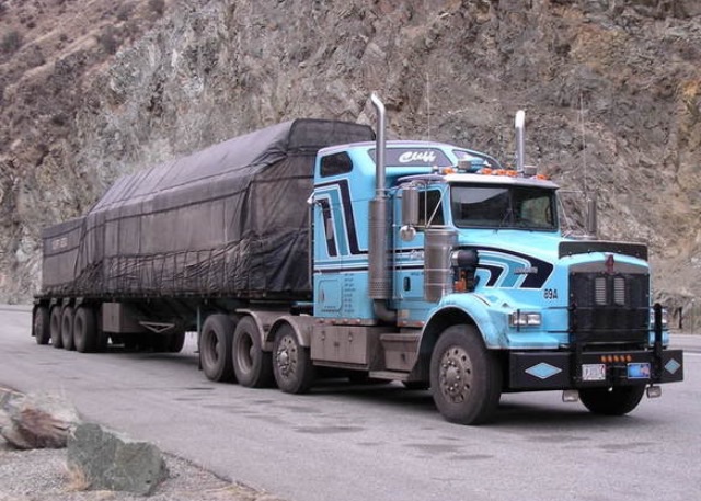

    Yeah. The 53' will need the overlength permit. I'll adjust where the drop is and see what options it opens up.
    I like the truck setup. Not particularly interested in two rear steerables - but I can understand why he did that.
    I've considered a 48' tri-axle, but right now I see more flexibility with a 53'. Like @RGN noted, I'll adjust the drop and see where I land.

    Small bunk, small fuel tanks, get a bigger spread on your lift on the truck. Then you can get under your trailer more and still have a decent 7 axle bridge.

    @RGN and @Long FLD, thanks for the suggestions and pointing me at a solution I wasn't quite looking at.
    It took me a couple of hours with Excel and the Oregon weight permit charts/website last night, but I got it to work. All I needed to do was move the lift axle closer to the front for the weight spread (sometimes drawing it out by hand and making changes just doesn't work as well).
    As long as I can suck up 18" on the 5th wheel, I'll be at 5.49 ID off-track.

    BTW, @RGN, you have a 269" wb truck there. :) -- BUT, it put me on the right track (12-9 = 153" / 5-4 = 64" / 4-4 = 52" --- 269")

    From the build sheet: WHEELBSE:0006197 MM (converted= 244").
    Add 26" from center of drives to rear axle=270"
