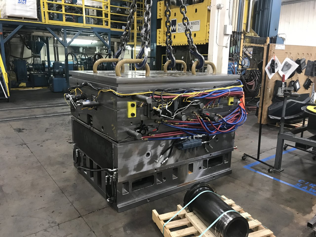

    I moved it forward on the deck one to many times. We moved it 3 times should have only moved twice. I wanted to be 40k on the trailer. It’s supost to be 72lbs on the gauge. I’m right at 72 but came up short. First weight I had the steer at 13.6 so I backed it off to this. Full of fuel. My empty should be 30.2k lbs? 063B7109-6BE2-4286-A46C-5EE75086F9FB.jpeg
    4B54C152-490C-425A-A609-9A0B5B9E7697.jpeg Permits are ordered.
    Thanks everyone for the help.
    The driving and the truck don’t scare me it’s all the other mumbo jumbo about each state that makes me nervous.
