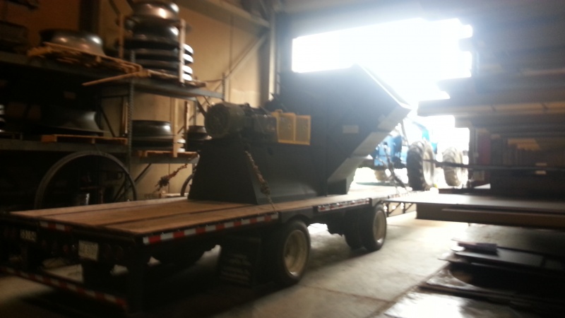

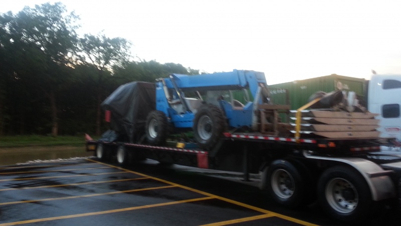

    I showed up to pick up my little big load today (hangs 2 ft over one side). The shipper was concerned because I already had a telehandler on the trailer. He didn't think I was supposed to haul anything with an oversize piece. I didn't see the problem, my permit dimensions covered the load. I follow my routing and deliver his part first. I dunno, maybe he was just mad because he thought I should have hauled it cheaper since I was making money on the telehandler as well.
    So was I right ? Or, are you supposed to just haul one piece oversized ? Didn't make sense to me, if he had another smaller fan I could surely haul that with the oversize one, so why not something from somewhere else ?

    dont see a problem as long as you are not over legal weight

    he wasn't really a dick or anything, he just questioned the legality of it. I didn't but heads with him, I just said it's no problem and assured him my permits were good and his part was coming off first. I think he was just a guy that is proud of his product and wants to micromanage everything. I don't blame him. He was just so ####sure of himself, it make me question maybe he knows something I don't !?
    LEAVE IT THERE ??? gheez Chuck, it's paying $3.55/mile by itself and I already had the permits. lol, I wasn't leaving it nowhere except where it's going so I can get paid.

    100% legal as long as you were not over gross.

    As long as your permit covers the box dimensions of the largest oversize piece and your legal on every other dimension your good to go. We load 12' wide and 14' wide on the same truck, the 14' is permitted and since the 12' is inside the 14' box dimensions there's no need for a permit on it till the 14' comes off. Legal weight, no front or rear overhang and legal height your good to go.

    Just ain't supposed to have two oversize pcs. on one permit. Since your other piece wasn't oversize, you should be good to go.
    The states that give permits stating "non dimisional load" refers to more than one over size piece.
    I just hauled an oversize excavator with several attachments. But none of the extra attachments were oversize. all good.
