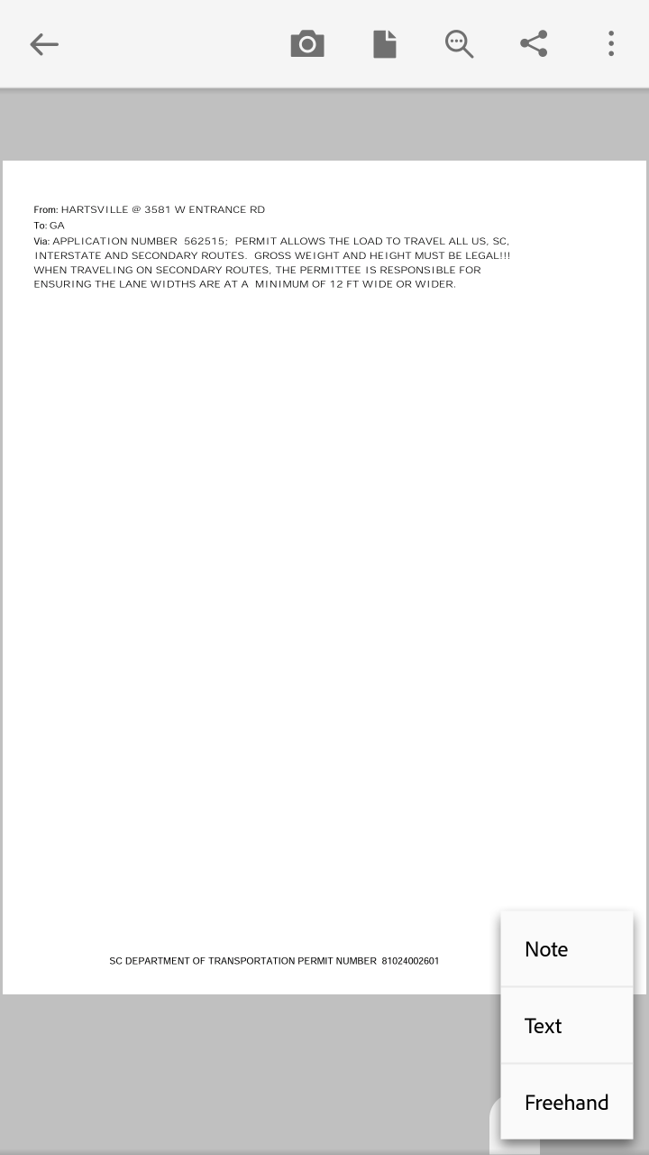

    Everyone of my Sc permits has this instead of a prescribed route.

    Those are not for overweight. Which is what this thread is about.
