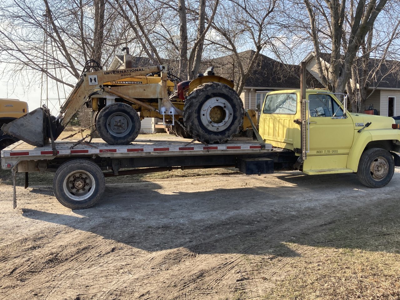

    I don’t know for sure but I wouldn’t be surprised if the timing is already faster because it’s a medium duty truck spec and not a dodge.
    They run better in med. duty
    I have a truck very similar to the op
    I help a neighbor haul hay in the summer with it I load to about 50k gvw and can whip his pump dodge even though he’s loaded around 30k and supposed to have a few more ponies Both are near stock and autos although I am geared a little lower
  5. W923
    W923 Road Train Member
    1,426
    4,418
    Feb 28, 2022
    He’s my truck
    Using a very expensive ramp to load…
