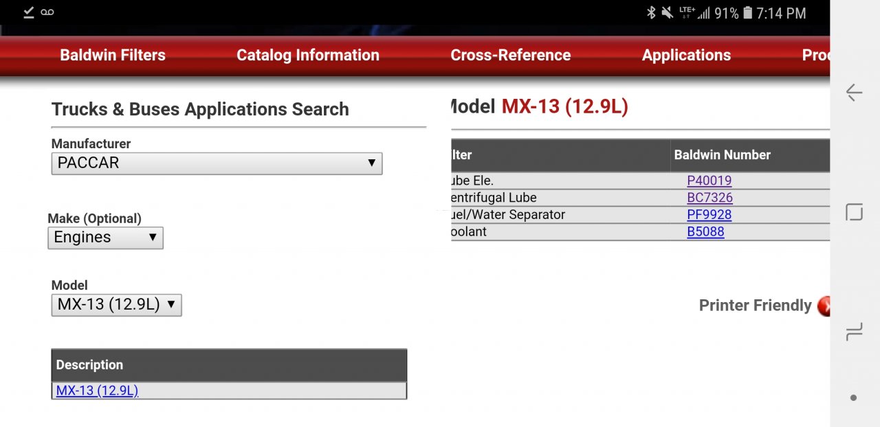

    Quick googling shows baldwin and luberfiner making filters. Im sure more do as well.
    No company would make an engine, then release specs of all the parts basically accepting they will never sell a part ever again.
    We have a large amount of owner ops that have the paccar engine and love them. Most are on extended warranty and some are over 1 million k.
    I will agree that buying any emission engine over 1mil can be a crapshoot as getting a good one vs lemon. Its not like buying a old cat and putting a platinum inframe in it and having a basically new engine. Screenshot_20180711-191453_Chrome.jpg

    Thanks for the tip on filters, I have not checked since last year but if baldwin makes them I will start getting them at my local Jobber instead of driving 35 miles to the nearest Peterbilt dealer.
