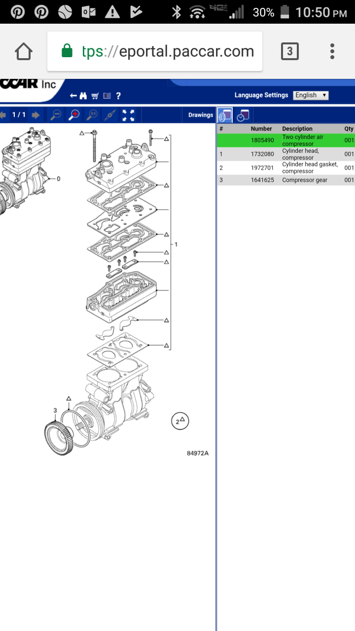

    The air compressor does have a cylinder head service kit available thru Paccar parts just like the Wabco on a Cummins. I can get you a P/N if needed. Cat ET was only technically available for sale to TEPS dealers and fleets. Fleet version was watered down. If independent shop had it, it was not legal version. You can buy Fleetguard filters, but don't be surprised when your centrifugal filters bearings go out. They spin about 8,000 RPM faster with the Fleetguard filter. DAVIE has it's good points and bad like any OEM diagnostic program. I feel like it has way better monitoring capability vs Insite espically with crankshaft speed overview. Much easier to find a misfiring cylinder. I don't work for dealership, but small fleet around fifty trucks and I have access to PVP, Eportal/Rapido, and DAVIE. Warranty support has been better with MX vs previous Cummins ISX and less issues with MX vs the ISX for my fleet.

    As of last month the air compressor did not have a serviceable head or relief valve, my dealer thought it did as well (even quoted me a price) but when I sent him the actual compressor number he said his kit would not work?

    Yep, I found the same thing on Wabco's site but for compressor model" (4510)
    912 518 103 0 both Wabco and Peterbilt said it would not work.
