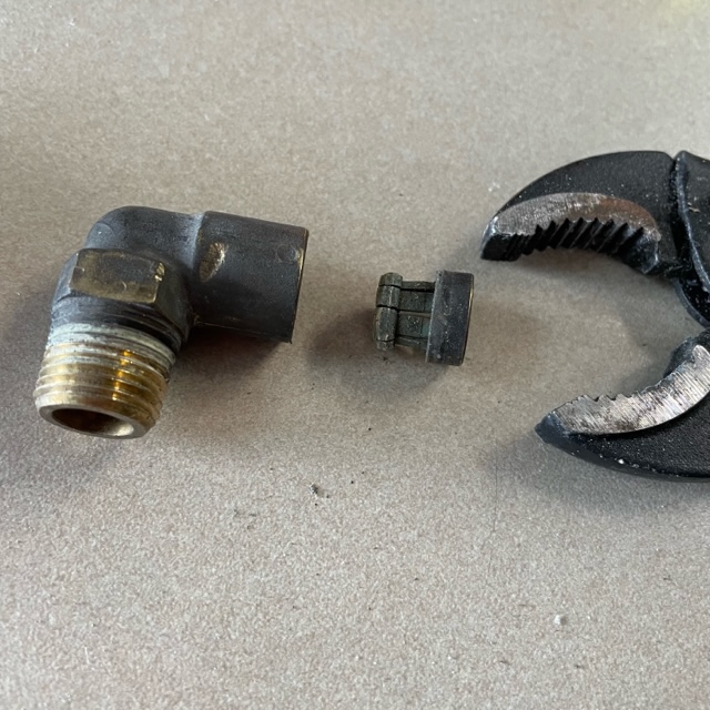

    Pull out with pliers...

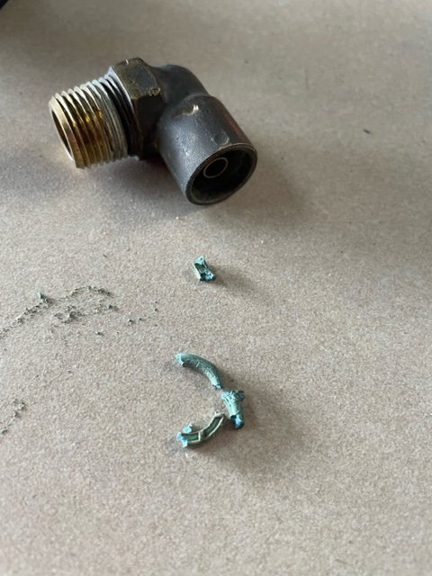

    Retainer removed...

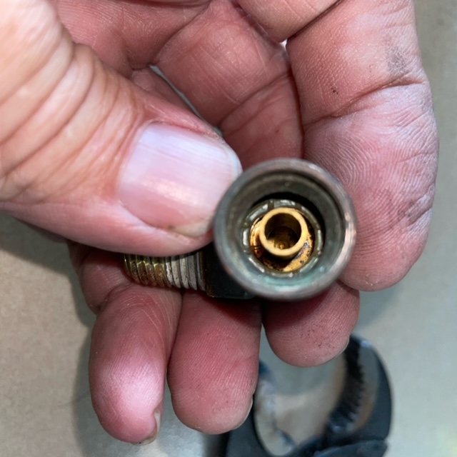

    What it looks like inside...
    The usual condition of the o-rings...
    Green o-rings are usually a little softer and seal better but don't last as long. If you still have a bit of a leak, try a little thicker o-ring.

    As these leaks occur just replace with compression fittings. Rarely have problems with compression
