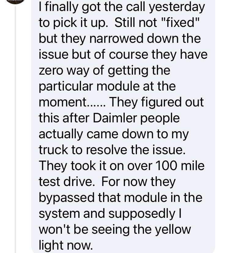

    Seems like Freightliner is up to deletions too…..sni FB page
