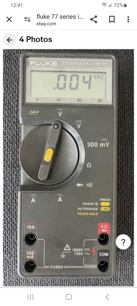

    Black lead in the Com socket, red lead in the A socket. Set dial to DC amps. Remove the negative cable as mentioned above and use the meter leads to "complete" the circuit. Make sure absolutely everything in the truck is turned off because the amp setting on the meters typically only have a 10 amp fuse.
    Don't neccessarily need a Fluke, a cheaper meter will work fine too for occassional use.

    Yeah,I bought one at a pawn shop about 25 years ago,$100.

    I got a model 77.I was going to a Power Plant School,needed for testing diodes and things.

    That's the one you got at the pawn shop?

    Yes
