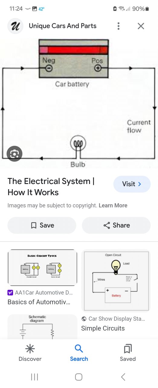

    If you google for current draw you will find a picture that shows direction of current with a load.
    Dc current on automotive is reverse dc current in the practical world.
    You will see arrow goes from negative to positive to load back to negative.
    Current starts from mass electrons to lack of electrons. Positive being mass and negative being lack.
    By checking only negative. All you're seeing is the return. Positive pulls more. Goes to load. What doesn't get used returns to negative.
    So you check Positive first. Negative second. Subtract negative from positive and that's your current draw.
    Current flows from mass to lack. Positive meter goes to positive battery. Negative meter goes to positive cable. On the negative side. Positive meter connects to cable and negative meter goes to negative battery. Reversing the connection shows a negative reading on the meter.
    The clamp meters have an arrow on the clamp for current direction. Arrow points away from battery on positive. Towards battery on negative. Reversing the arrow will show negative reading.
    If you have dirty batteries. Dirt also acts as a conductor. Put one meter on the battery terminal. Negative or positive. Doesn't matter. Run the other meter along the top of battery. You will see voltage reading on the meter. That's the voltage seeping between positive and negative. Dirt shorting the battery. Screenshot_20240121_112416_Google.jpg
