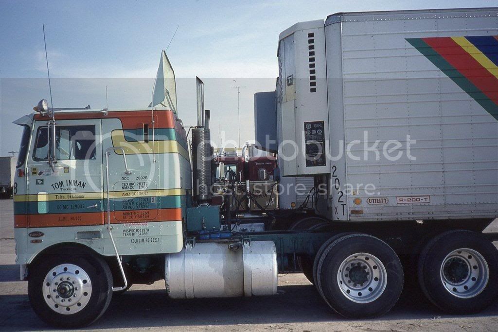

    That paint scheme reminds me of the old Tom Inman trucks.
    Oxbow Thanks this.
