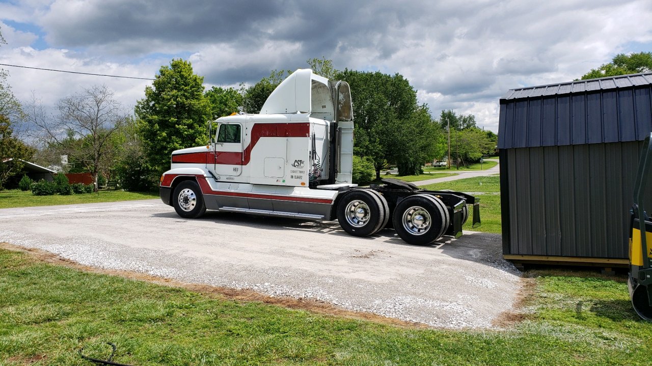

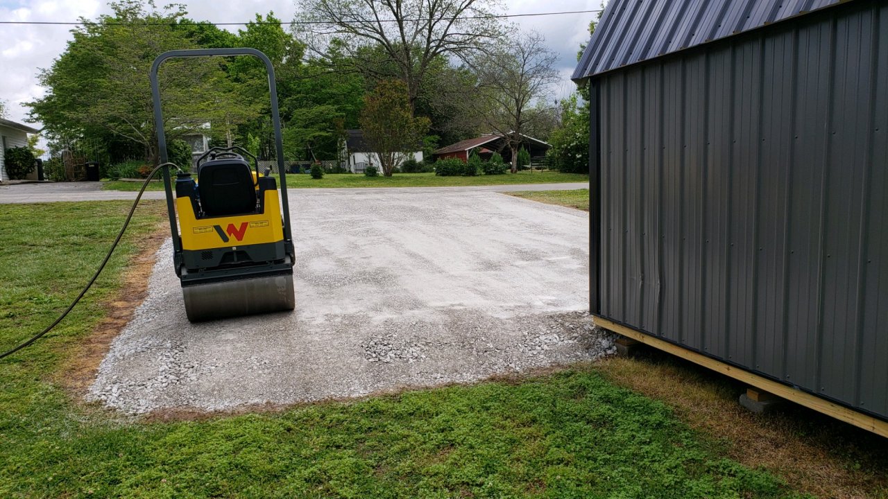

    Don't overthink this or get too crazy with it. I say you should scrape the grass off the top before you put rock down but in this parking spot in the pics I made I didn't do that. This was a job I did in a hurry a few years ago that turned out nice and still looks/works good.
    I ordered one truckload (about 21 tons +/-) of inch and half rock (about $425 delivered) and had it dumped inside of where I spray painted the lines where I wanted the rock pad. The driver backspread it for me which saved me some extra work spreading it with my little tractor grading blade.
    Once I spread that like I wanted I used the steer tire of my big truck to "push it in" driving back and forth over it several dozen times. Then criss crossed it like that.
    Then I ordered a truck load of crusher run gravel. 21 tons+/- for about $350 delivered. Crusher run is finer gravel and powdery lime dust when dry. It washes into the bigger rock as it rains or you can water it and kind of binds/cements it all together over time. So the driver backspread the crusher run as he dumped it then I smoothed that out to my liking with my grader blade. Then I used my bobtail truck to again drive back and forth over the gravel criss crossing it and pushing in that crusher run.
    Then I rented a roller from the local equipment rental place. It has a water tank you fill that adds weight and also vibrates and sprays water as you roller over the gravel. This thing did a fantastic job compacting and washing in that crusher run material.
    I built this parking pad almost 4 years ago in a day for under $1,000. It's about 6" thicker, taller than the ground it's on. It'll park two bobtail trucks. It's still solid, like concrete now. I figured with about 6 or possibly as much as 8 more loads of rock it could have been expanded enough to get one 53' trailer in there.
