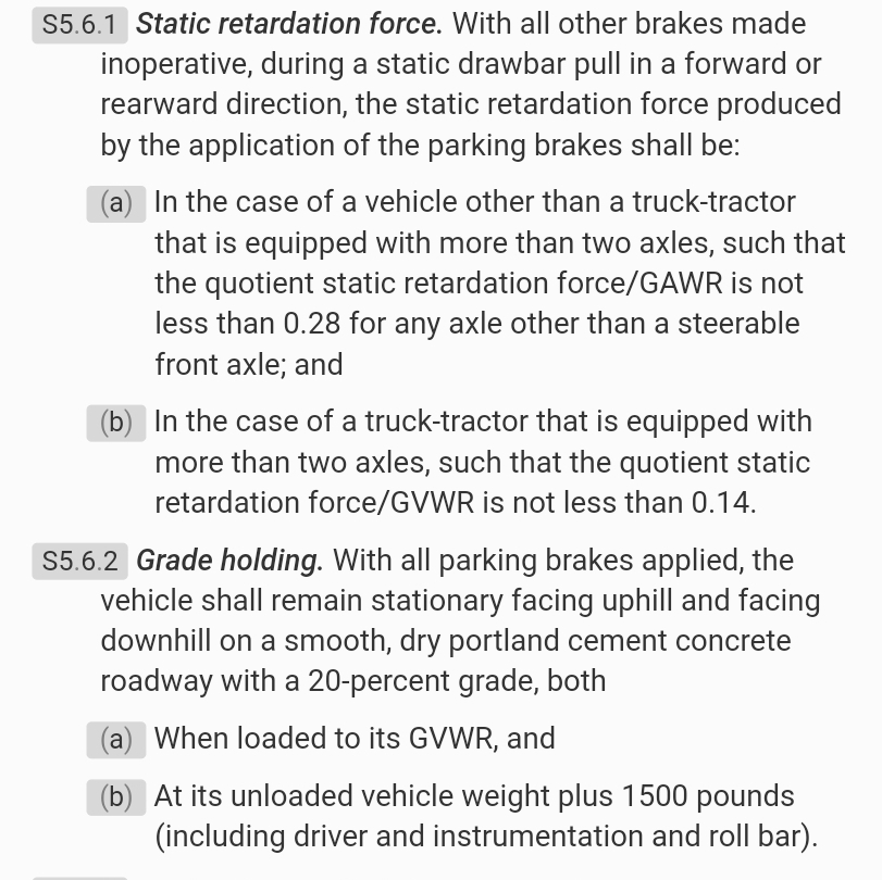

    Hey everyone,
    So, I read somewhere (specifically CDX Learning Systems - Fundamentals of Medium/Heavy Duty Commercial Systems 2nd edition) that a truck does not require parking brakes on both axles if it is less than 52000 GVW and does need them on both if it’s over that.
    Does anyone have any information in state law, FMCSR or otherwise that backs this up? Everywhere I look simply states that parking brakes are required on all axles no matter what.
    Thanks guys!
