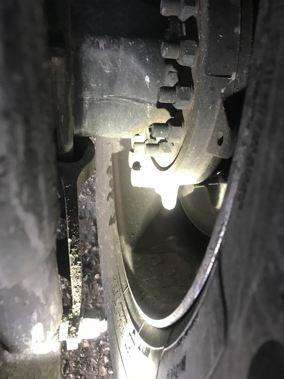

    I do that when I’m at the terminal and can go under the trench. But as an example of a new guy situation, I got put OOS in Georgia for inner wheel seal leak. So I am being extra careful. Now today I find this. I called it in unsure and just paranoid. What would you do?
    It wasn’t raining or anything and all the other wheels are dry

    I would get on the ground and inspect it. See if it’s oil, find its source. It looks like it could be a wheel seal or maybe not. If it was leaking and your in a company truck, it needs to be fixed.
    Jwhis Thanks this.

    I tried. I can’t physically fit under the truck but I got down there and lied down ran my finger all up around inside there just grime no oil per se.
    Lepton1 Thanks this.

    Well. You could clean it with brake cleaner and a rag and keep a close eye on it. If it is a seal, you don’t want it running dry in there either.
    Lepton1 and Jwhis Thank this.
