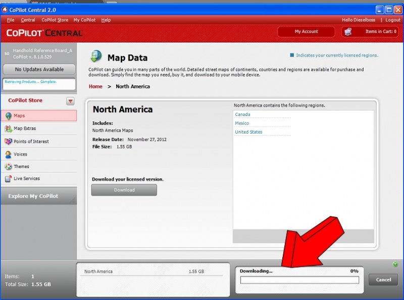

I have the GPS unit connected to my computer and all of the maps are dated 3/3/2010. The unit is a 550, I checked on the back. I installed CoPilot Central 2.0 and just downloaded the November 2012 maps to my computer and now I am trying to figure out how to get them into the GPS unit. The directions are not very intuitive. Thanks for your help.
Ok. I am confused again then. There is nothing that you have to do to transfer the maps to the GPS from CoPilot Central after they download. After you click "download" it will download them first and then automatically say "TRANSFERRING" in the same box where it said "DOWNLOADING." Please refer to where I put the big red arrow in picture here:
When it has completed transferring them, it will just show the red CoPilot logo in that box.
TURN THE POWER OFF for the GPS and then unplug it from the computer. Then turn the GPS on and the maps are done. You can verify that they went on in the "About CoPilot" screen mentioned in the earlier post. -
