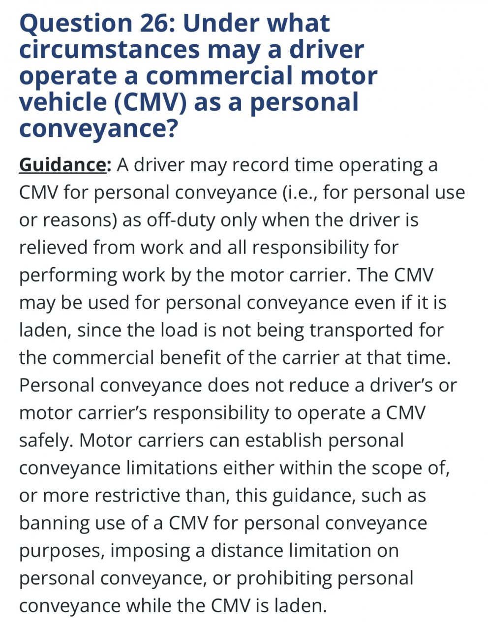

  9. Long FLD
    Long FLD Road Train Member
    13,078
    54,877
    Mar 4, 2015
    Right, and the your last two sentences aren’t legit uses of PC. If it’s a legit use (if you can do it in a taxi, for example) there is zero issue dragging a trailer. Here’s this if you wish to keep arguing.
