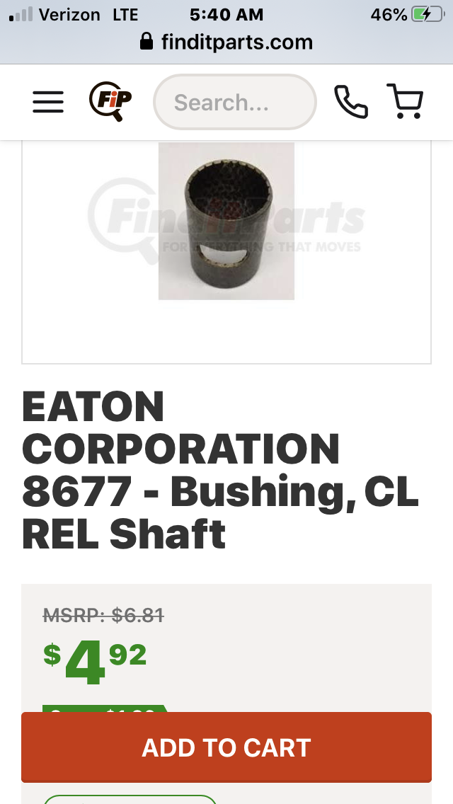

    They make a one piece Reamless bushing. When I bought my fork kit, the shop suggested them. Claimed that’s all they use. Easier to install one (instead of 2) on each side. Can easily be reamed a bit if slightly damaged while installing.They're softer than the Originals. I literally used a screwdriver to straighten the one side, that got a little buggered up, pounding it in. I think they were a copper alloy mix. Depending on if you need the fork kit. The right side can be turned around, putting the worn part against the fork. The linkage side, if worn you’ll have to buy. In that case, it’s probably better to get the whole kit. It’s cheap.

    31C7226C-8213-475F-A06D-7CE117BDFFC6.png Not sure if this is the part # you need, but they looked like this. Just have to line up the hole for grease. Shout out to @BoxCarKidd for talking me through my Clutch job. I had bitten off way more than I could chew!! Thanks again.

    Thanks guys I appreciate the info. I will definitely check out the one piece bushing as well. I did find that the slip yoke was about one tooth off so that took care of most of my vibration. Multiple picks up in south jersey today and only thing I can feel is may be in need of new shocks but no driveline vibration.
