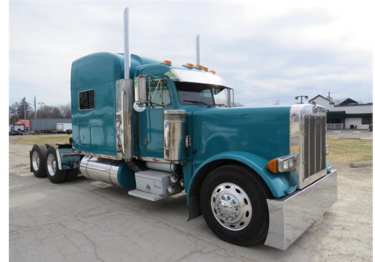

Have a question about the fifth wheel, my trailer is sitting about a foot or maybe less, but it's higher than most trailers out here, I noticed there's a leg welded between the top of the fifth wheel and the track, can that be removed or do I need to buy another fifth wheel or slide?
I'm a newbie, the fifth wheel question might sound dumb for you all, but just curious, how to get my trailer even, it sitting way high in the front, and slouching in the rear....
You have a high rise plate on yours it's not a big deal really mine is the same way I'm on lp22s now and I sit the same height as everybody else. It's popular in the industries with higher king pins like flatbeds and cow trailers

You need your fifth wheel height to be about 47-48 inches high for a van...nonsense007 Thanks this. -
You need your fifth wheel height to be about 47-48 inches high for a van...[/QUOTE]
Is that 47 or 48 inches from where to where? So I can measure in the morning. -
From the ground to the top face of your fifth wheel plate

Ground to the center of the top plate if I recall correctly don't remember exactly. And regardless of what anybody will tell you 14 2 will clear 14 foot you just have to dump the suspension don't ask me how I know.
####ing Chicago never againnonsense007 Thanks this. -
Ok perfect, will unhook in the morning, and check the measurement. Cause seems extremely high.
