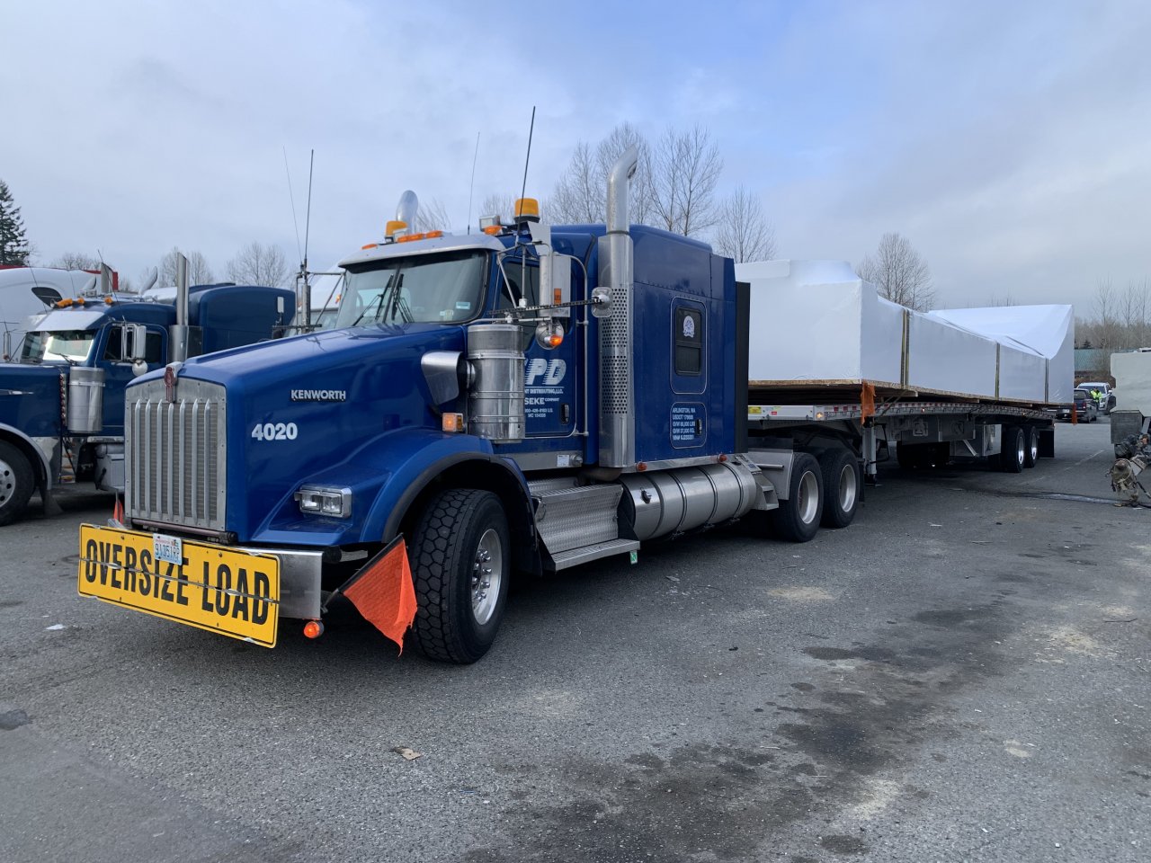

    Possibly switch to larger front tires and run at less pressure? I run 385’s and around 85 psi and my t800 rides decent for a SBFA. Plus they look cool. 385’s will require different front wheels also. 07FBB427-E38D-497E-BD23-E2BA62895AFD.jpeg
    ducnut Thanks this.
