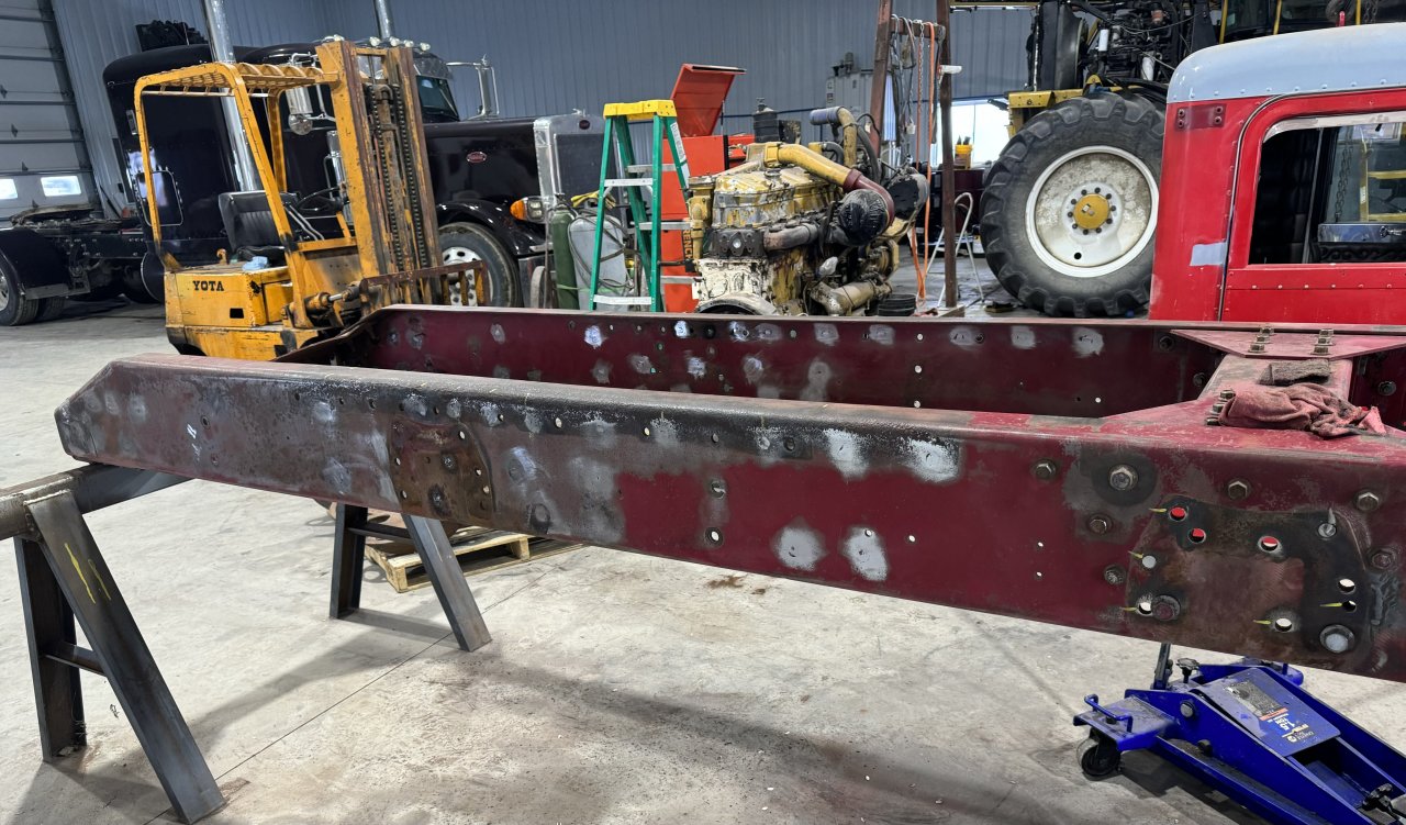

    Ball park figure what it cost ya ? I have a set of Eaton DST 41 that I getting ready to roll under a 359

    Mar 15, 2021
    Gotcha I understand completely.. the picture I posted… that started out as I was gona just buff the paint.. so I know the snowball effect all to well

    I know how you are too lol… Just like you I start something and see something I don’t like and think well I’am right here might as well go alittle deeper and fix this too and next thing ya know you arm pit deep and still digging
