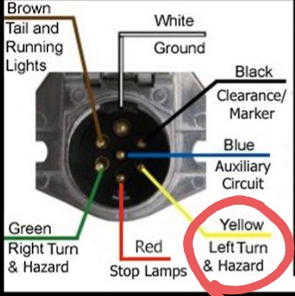

  10. AlexLia
    AlexLia Bobtail Member
    20
    2
    Oct 6, 2021
    If you talking about this pin marked with yellow line - it is not.
  11. bad-luck
    bad-luck Road Train Member
    3,292
    6,056
    Nov 16, 2013
    Baltimore, Maryland
    Yes. Where the wire going into the back of the scoket. Use your test light and it should blink.
