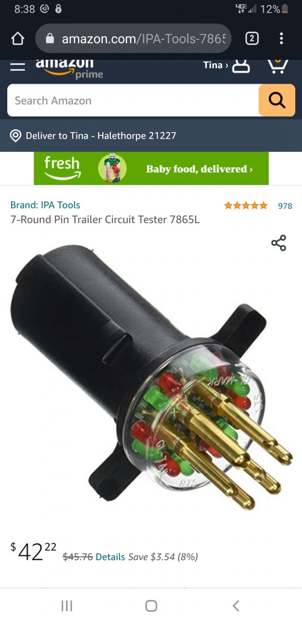

    They actually sell a tester that plugs right into the trailer socket. Here is one. And your very welcome! Screenshot_20211009-203817_Chrome.jpg

    I already know that there is no power on that pin for trailer left turn signal. Why to buy it?
