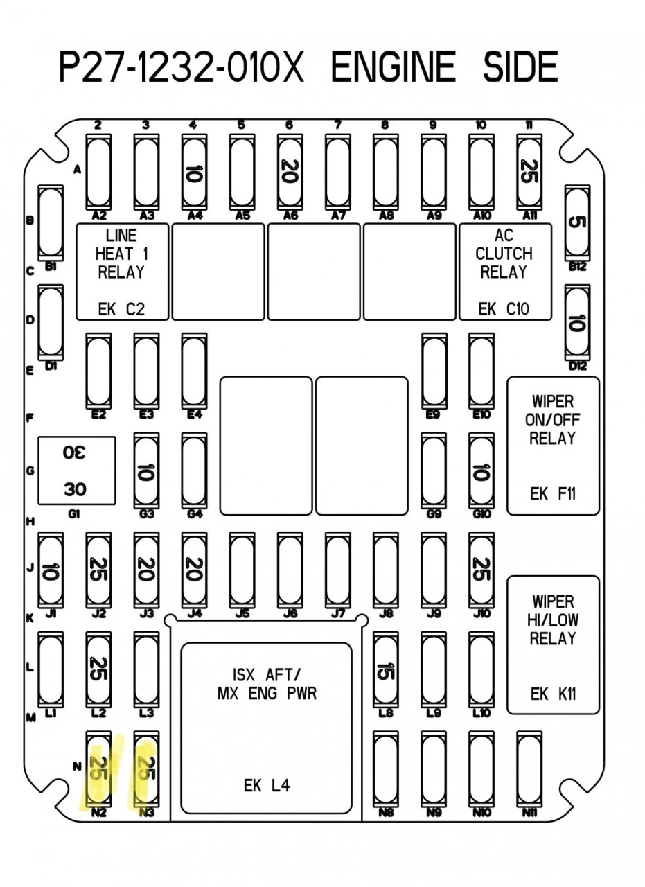

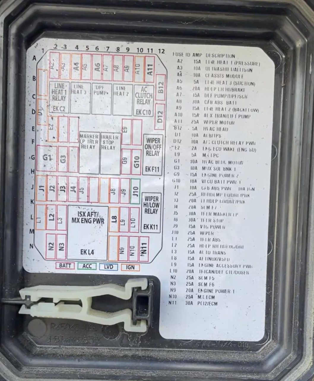

FYI, My 2022 Pete 579 had this issue. It was the N2 fuse under the hood. It does not say anything about (Trailer) on my diagram, but it was the broken fuse. It says “SCM F5”.
Flatbedgrl253 Thanks this. -
Well I didn’t have any 25 amps but a 15 is working for now!! Thank God I can turn left now!! thank you so much!!
