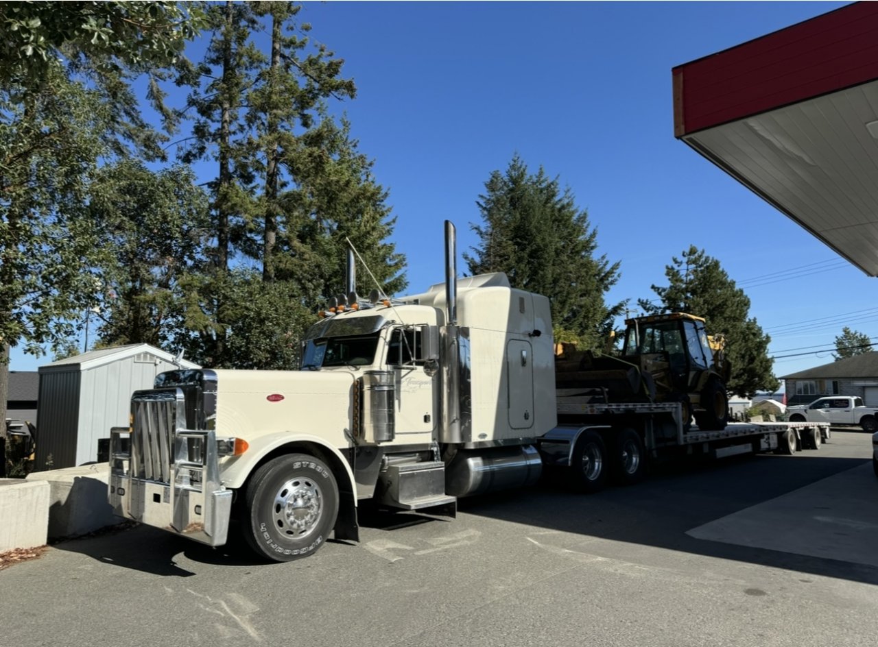

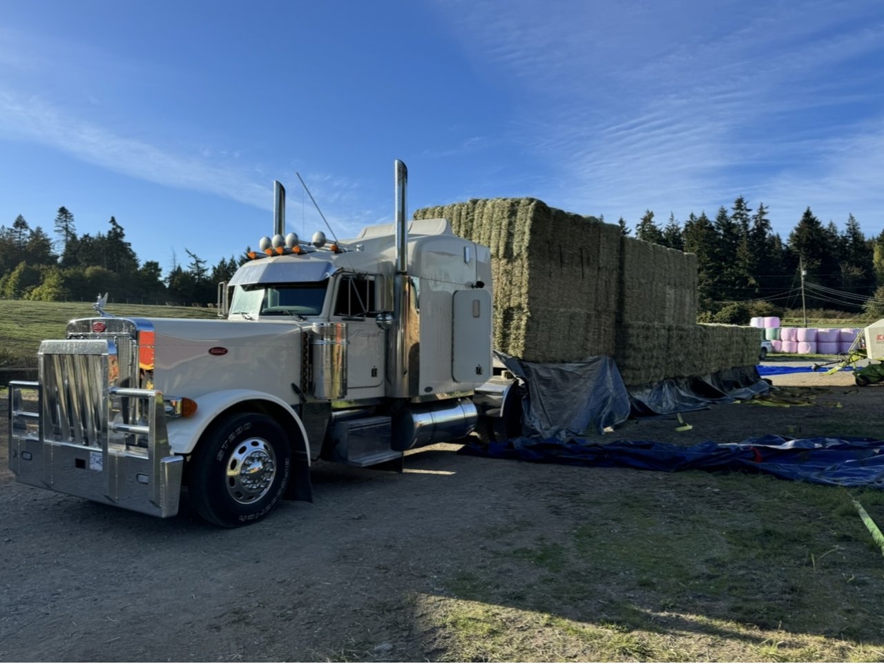

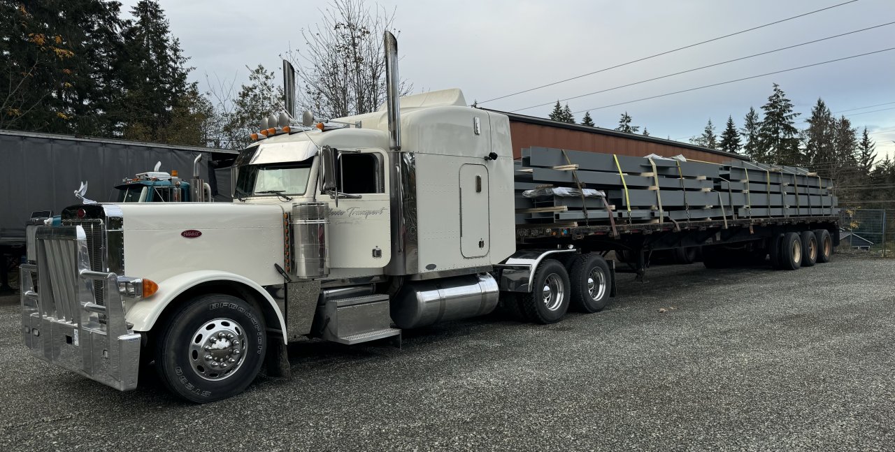

    It is actually an aluminum hood, i just replaced the hinge bolts and changed all the bushings, a bit better, the actual arm on one side is a little worn out, causing it to drop lower on one side. Anything else i can do to properly adjust it? Should i add shims in the front?
    I also noticed obviously the angle of the photo makes it appear more sloped than it actually is… what do you think?. IMG_1572.jpeg IMG_1571.jpeg IMG_1564.jpeg

    I question your photography skills and hell I ain’t no better but it sure looks better now.

    I came upon this thread because I was wondering what the reason was behind the slope on some 379exh and some not having it. The picture really shows the difference.

    ...I don't see your mentioned difference here , probably just camera angle ..you can clearly see the angle difference on short hood vs extended one ...
