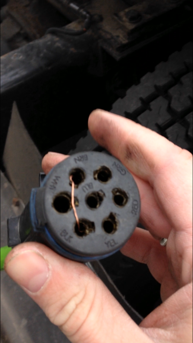

    Hi everybody, I have Pete 387, 2007, I've tried to find that fuse box for trailer which should be on a left hand frame, behind the cab, but still have no luck at all, there is just no box at all, I've been following cable all the way to the engine until it was covered and mixed with others wires so I can't follow it. Maybe anybody have knowledge where Peterbilt could possibly hide it. I had temp, jump wire fix, but wanna find those little ########.

    Yes sir, I found those in gloves compartment, above and above the washer tank, and in the right sleeper box, but problem is that they don't contain that fuse which I need. I've called Pete last night and they told me that it most likely moved from the frame inside left handle sleeper box. But still no luck yet.

    Actually I found those fuses and relays, they not on the frame anymore they in chassis load center, but problem still exist, I checked power in my cable, so both black and brown holes in the connector from truck to trailer have power, which basically means I suppose to have my lights on, but I only have them on if I connecting them together with a temporary wire.
