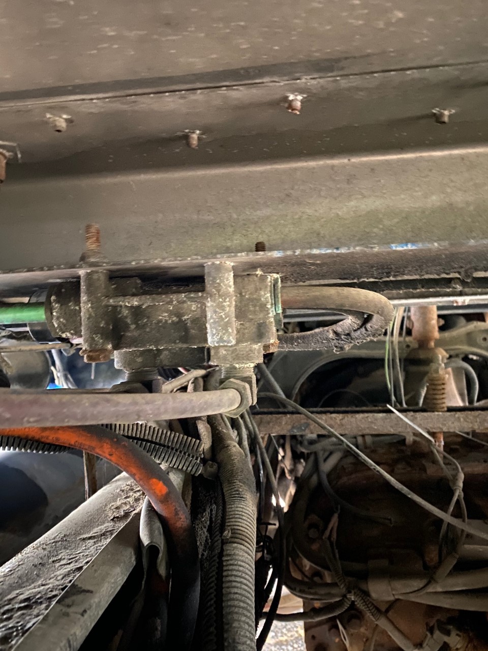

    Thank you Chris. Primary and secondary air tanks are full. I was told it might be the low pressure sensor which is in this picture that I have attached. The sensor that hooks up to this valve under the cab next to the green hose. PART#830-0005-000. I will check underneath the truck the box that gets all the information also. Thank you sensor.jpg sensor.jpg sensor.jpg

  5. Chris M.
    Chris M. Light Load Member
    123
    87
    May 27, 2010
    Tater State
    No worries. Also it’s about the size of a large phone and has about 3 air fittings going into it. Inside the frame rail.

    The pressure switch on the tractor protection valve under the cab is the brake light switch on 387.
    Ditto on the interface module as suspect problem with the gauges. Check power to it as well.
    kloria and Chris M. Thank this.
