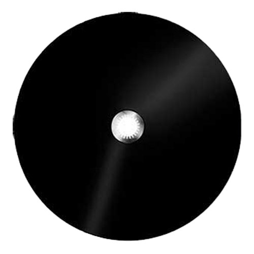

    I Install a teflon 5th wheel cover and the vibration wen away.
    Just my 2 cents.

    bbt_387 I have heard of those slick disks, might be a good try. I'm not sure but I don't think they would dampen the vibration very much. Unless there is another reason I should be using one?
