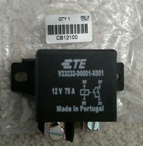

    There is a small relay behind the panel on the left of steering wheel. You have to remove the dash panel to get to it. This relay can go bad and the truck will not start. I have a picture of it and I will post in a moment.

    Here is a picture of the relay.

    I would start with that and see what happens. If it isn't that hold on to the old one. You WILL have to replace it one day.
