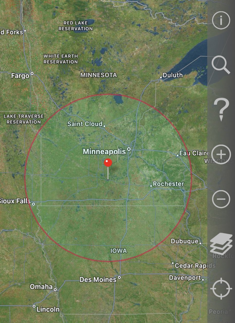

    That pretty much covers it. Its really not that hard to understand. I have an app that would show a circle, centered whereever I wanted it, on a map. I would center the circle on the shipper set it to 150 mile radius so I could figure out exactly where I could start and stop using Ag Exempt. Sometimes it made 1000 mile days possible... My best day was 992 miles.

    Let’s just say for poops and grins he was loading in Mankato. Once he hits the edge of that circle going in he can run PC on his log, or if he’s unloading somewhere within the radius he won’t have to go on duty at all once unloaded. Then once he’s loaded he wouldn’t have to start his log until Ames IA it looks like. For fun let’s say he emptied out in LaCrosse WI. He could get empty and run a couple hours up the road, grab a bite to eat and a shower, maybe nap a couple hours, run over to Mankato and load, then run a few hours down the road and nap again or something. The main thing about the exemption is not having to log a single thing within that radius. No drive time limit, no 14 hour limit, when used properly it just makes things easier. It also saves hours on your 70 too.
