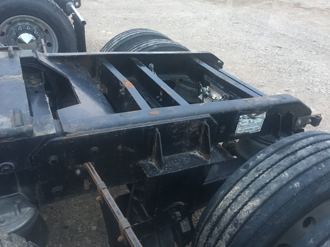

    I did get some pics of one of the units in the yard but I've been stoopid busy pulling a sand can I'll get them posted when I get a down day time to sleep now.

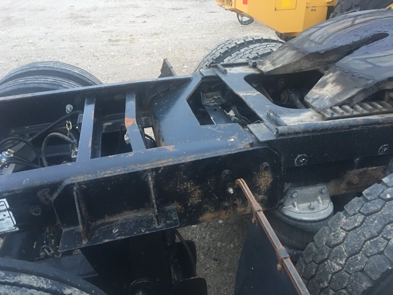

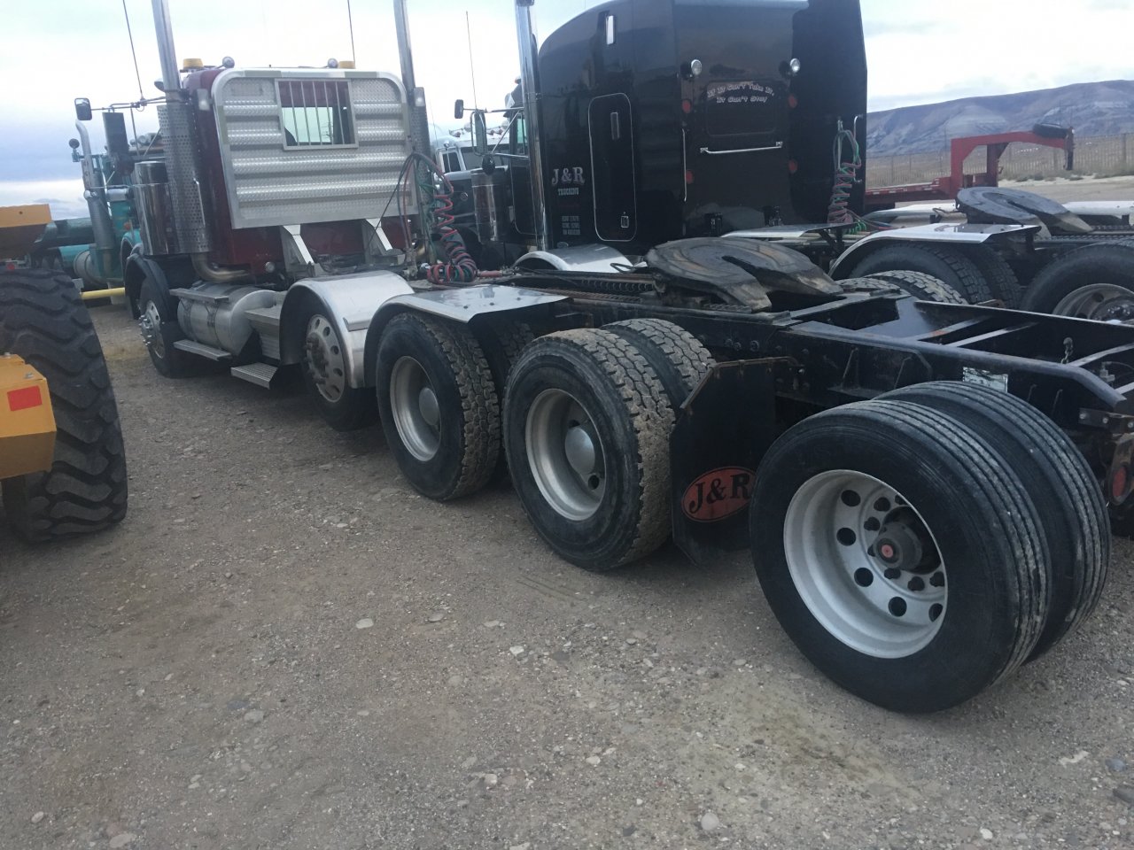

  5. haulhand
    haulhand Road Train Member
    Here is the photos as promised. As you can see it's just bolted to the back of the frame and is most definitely a lift axle.

    That's not really a pin on per say, the ones I was thinking of pin on like a trailer axle.

  7. haulhand
    It actually works better than a trailer pin on. It's quick and easy and quite a bit lighter. I wouldn't recommend it with a light frame tho.
    snowman_w900 and johndeere4020 Thank this.
  8. johndeere4020
    8,522
    119,295
    Jan 1, 2010
    You mean it comes off easy?
    snowman_w900 and 4mer trucker Thank this.
  9. haulhand
    Yea it takes about 5 minutes to unbolt and drive away from it. It is super easy.

  11. Caterpillar Cowboy
    Caterpillar Cowboy Heavy Load Member
    837
    607
    Nov 11, 2010
    Wyoming
    Thanks for those pictures Haulhand, I've been seriously thinking about one of these to turn my 4 axle lowboy truck into a 5 axle when I want it to be. Especially if I every wind up pulling a belly or side dump, moreso especially if the haul pays by the tonnage. I've seen some pictures of guys out on the west coast mostly pulling logging equipment, with pin on's similar to this. Including the pin-on axle some trucks are 5's and I've even seen a 6 axle truck.
