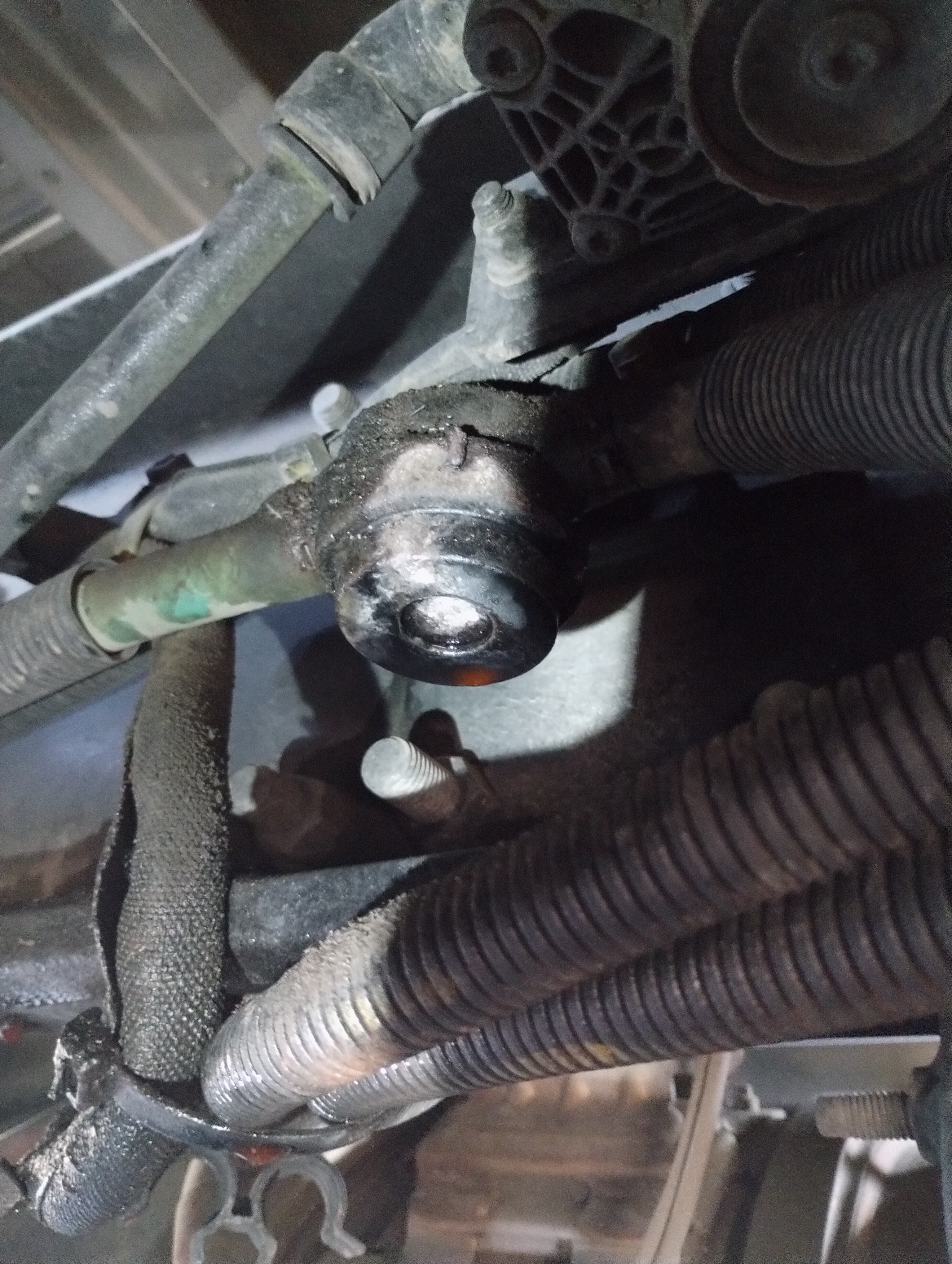

    can someone please identify this part above, it is leaking pretty bad under pressure and i would like to replace it, thanks for any help you can provide

    Can you post another pic or two maybe a little further out away from that? It might help someone who is looking and trying to help you with determining what it is called.

    as soon as i get stopped ill get under there if there is enough light with a flash light to look, its the round piece in between the two hoses where you see a drop of coolant leaking from, the hose runs along the passenger side rail underneath the cab

    What is it on, what truck and what engine?

    2023 peterbilt 579 epiq ultraloft, cummins x15

    DEF heater coolant screen/filter

    trying to find that part or one that looks similar, using those terms, but not having any success, any other terms i can use to locate it ?

    It is a new part for 2023 related to the DEF Q sensor failure issues. Let me see what I can dig up for part numbers for you. It will be Paccar dealers only.

    Warranty. Take it to the dealer

    Came right up under DEF coolant filter.
    M37-6277-002
    please check your VIN for the correct part number.
